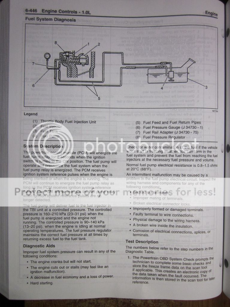

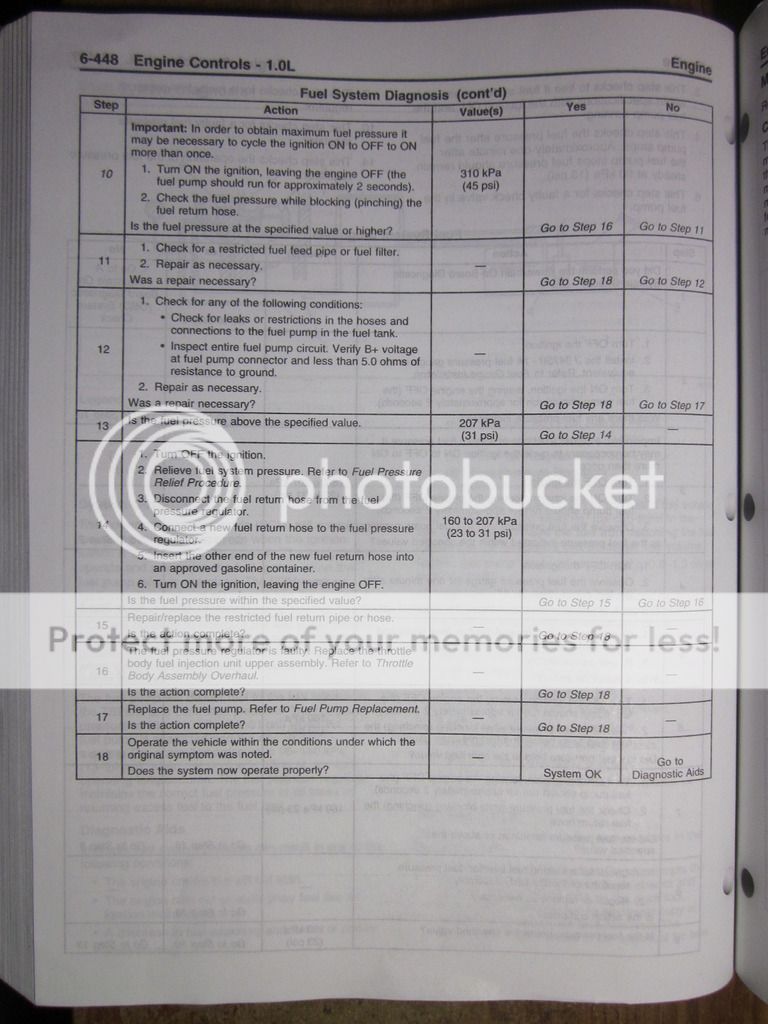

Here is what the 98 FSM has for fuel system diagnosis. Looks like the fuel pressure is higher in newer cars than the older ones. Hope it helps in some way.
