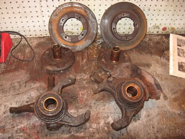

But.............If your rotors look like this,
And you have the cheapest pads possible, that's a big problem, as well. ;)
Let's pretend all other brake components are good. :hmm But the rotors look like above. :'(
You'll be amazed at what new rotors, and pads edge code FF or better, will do for the stopping power. :cheers
