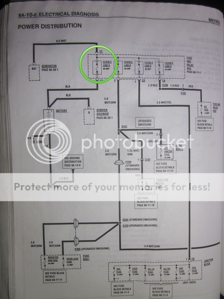

We then realized the main fuse 60 amp had blown. A friendly truck driver and self proclaimed "mechanic" came over to help. He immediately brought some basic tools and tightened the connectors on our battery, the hot and ground. made sure they were secure. then tested the battery. It had plenty of juice. This was at 3:00 o'clock in the morning so no auto parts stores were open. He rigged a steel pin with copper wire on either side of the main 60 amp fuse and the car started fine, we test drove a little and everything seemed ok.

Could we buy a new 60 amp fuse and replace it, safely and expect the car to run fine?
The 60 amp fuse needs put back in. I would also check the bottom of the fuse / relay box to make sure there is no corrosion. The 60 amp fusible link protects the wiring from the alternator to the 60 amp fusible link. Make sure your connections on the alternator and battery including the ground are clean and tight. The battery and alternator should be checked to make sure it is working properly.
