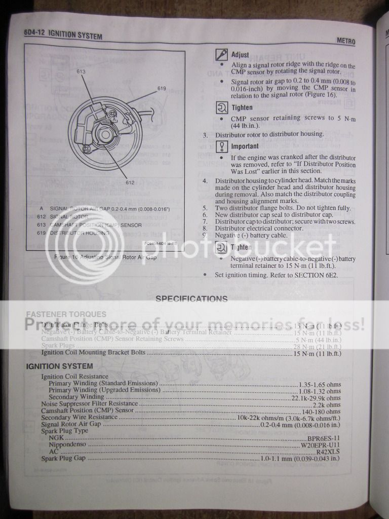

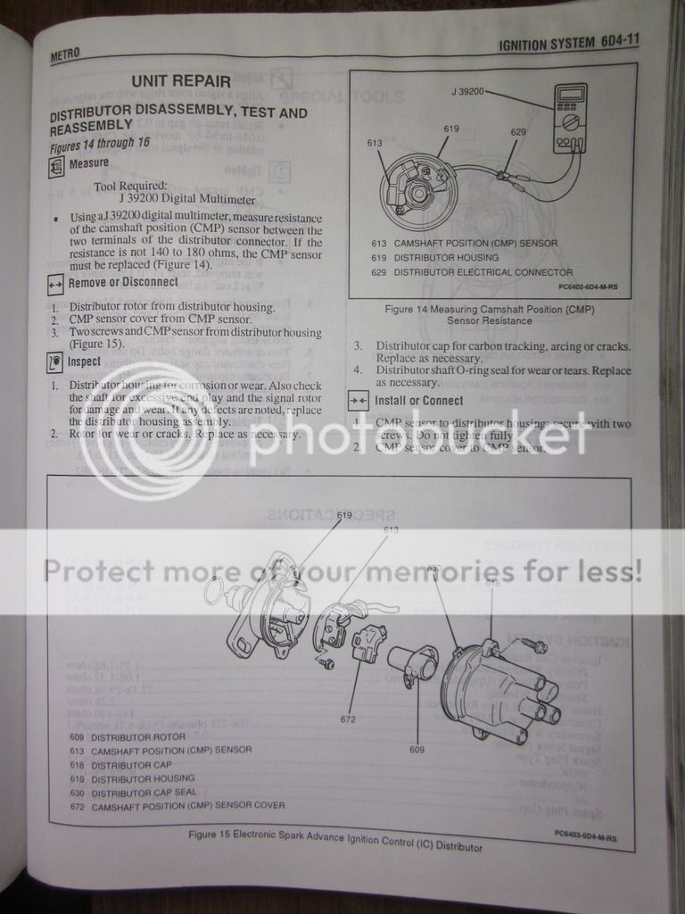

When you replaced the CMP did you set the gap?
If you haven't seen the 94 FSM link here on the forum here it is.
http://geometroforum.com/topic/5044844/1/#new The section you are looking for is 06D4 IGNITION SYSTEM.

Yep, been there done that. My 96 did the same without any warning. The tiny shards of copper wire were everywhere, so I pulled the distributor to make sure I removed it all. Rather easy to set the gap on the bench compared to bending over under the hood.

If you are in the right position to start with it's easy to remove/replace. Just take a sharpie and make a match mark before you remove it, not where the rotor is pointing, remove and do the work, then replace with rotor in the same orientation - line up the match mark, tighten the bolts, replace the cap and you are done.
David95237
BTW the distributor only goes in one way.
Hanuman
the cam position sensor (pick up coil) is inside the distributor under the rotor.
remove the cap. its black. 2 philips screws.
signal voltage while cranking is 0.10 to 0.40 volts A/C
star rotor to pick up coil gap is 0.2mm to 0.4mm
Set the gap using a brass feeler guage

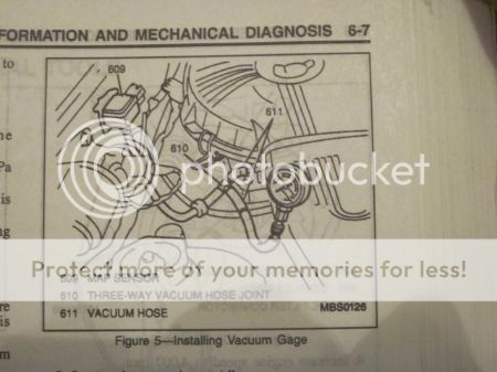

checked a vacuum line on the front of throttle body had very little vacuum at idle but increased when I increased throttle.
Which vacuum line did you check? You should attach a vacuum gauge to the map sensor like in the picture below.

removed the distributor set the gap re-installed the distributor and started right up. installed jumper wire to check base timing and found it to be set at 0 so I set it to 5btc and its running great even better than before. found a crack in the vacuum line and replaced it now all is good. thanks so much for all your help and knowledge.

FYI there is a vacuum line on early metro (never checked this on later ones) going to the evap system that increases in vacuum as rpm/throttle increases. I observed this while working on a 93 xfi recently.
Let's just say I was scratching my head as to why the engine had 8" vacuum at idle.....then I bliped the throttle

Also, the reason why a improperly spaced pick up coil leads to hard or no starting and poor running is .............
to big of a gap causes weak or no signal pulses from the pick up coil.
The signal is what tells the computer to provide fuel and spark.
Both spark and fuel injection is timed to the movement of the valves and pistons (simple explanation)
With out the pulses from the pick up coil there is no spark and no fuel. If a pulse is missed a fuel injection event won't happen and a spark plug discharge will also be skipped
