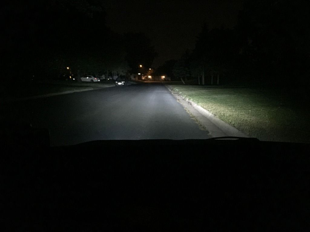

So I removed the led bulbs and put in halogen 9003 bulbs and that did the trick this is with Wagner tri color bulbs. I'm pretty pleased just a little better than the sealed beam.this is low beam bellow

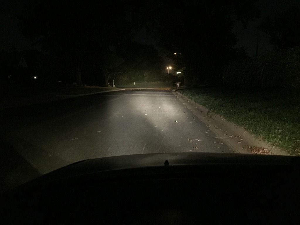

This is the hi beam definitely pointed left. I thought I had the low beam alignment pretty good. I will have to get out too the country to see how it looks on a dark road

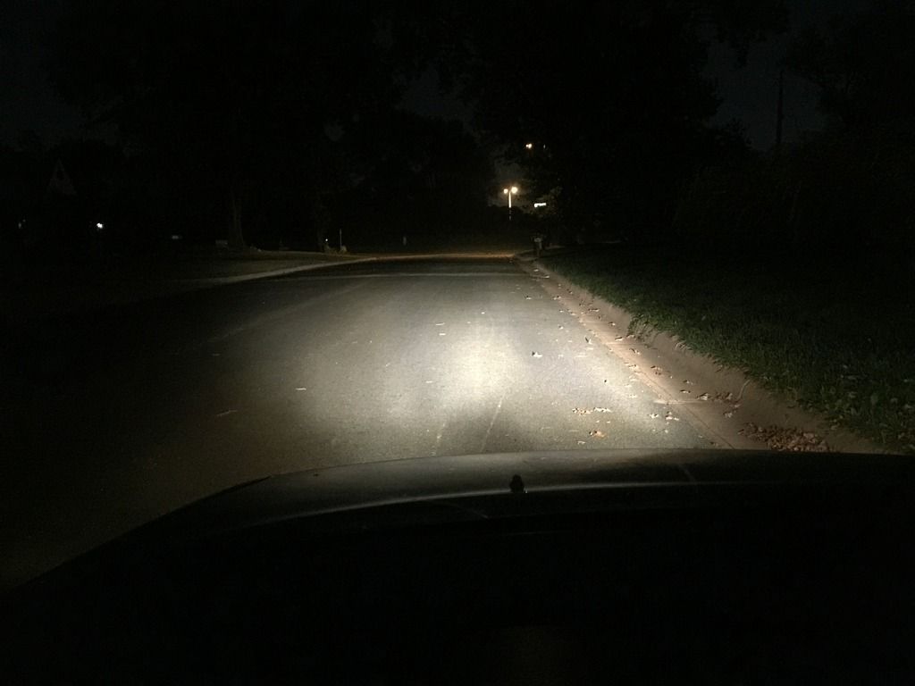

Here is how the led's look in my girlfriends 2013 rio definitely works better in her car. This is the low beam

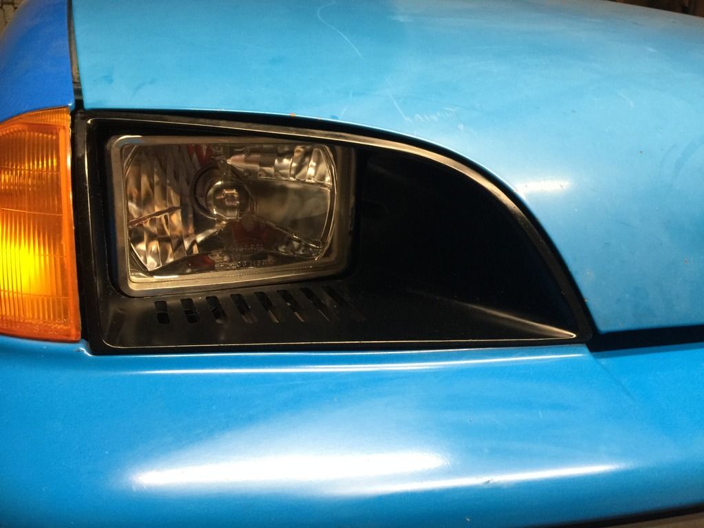

I removed the center piece out of the socket hoping it would fix the led dark spots but no luck. The aiming was a lot less wako with halogen bulbs. Not sure what these reflectors real purpose is. Definitely would be harder too put them back in but not impossible. Anyone know their purpose?
Are they just so oncoming drivers don't see the bulb directly?

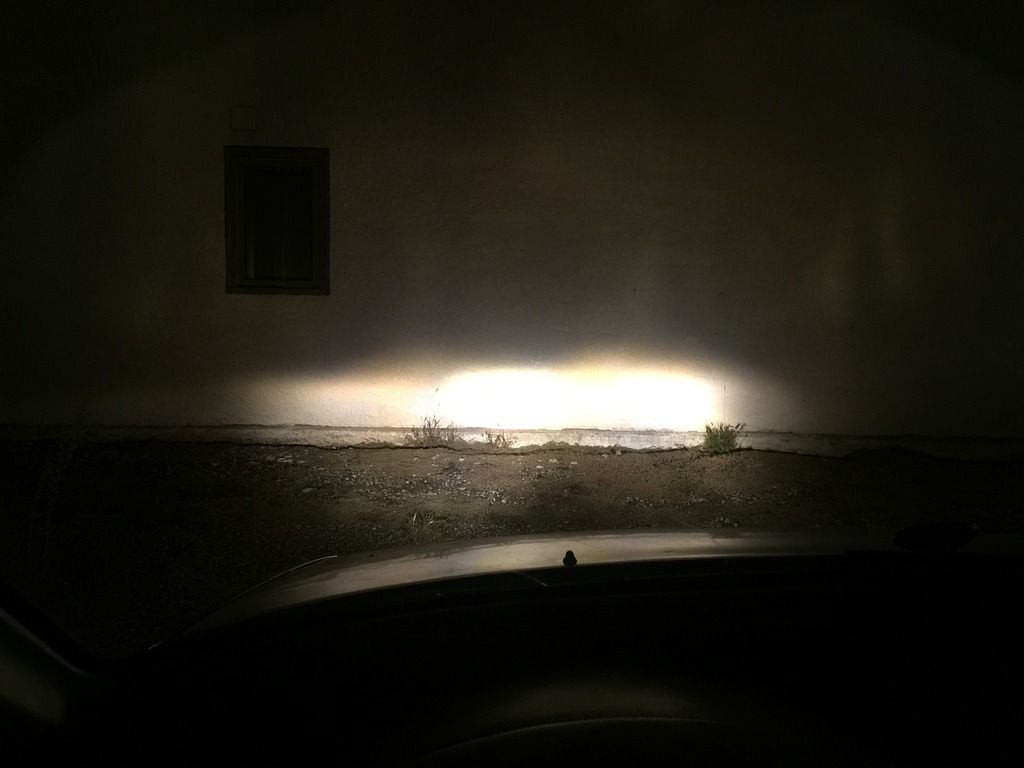

Here is the lo beam against a building

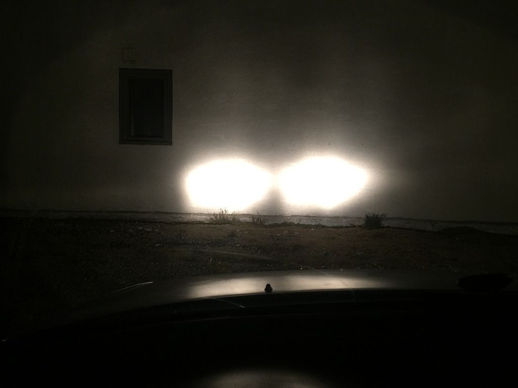

This is the high beam
I am returning the led bulbs I bought they put a spot light directly into oncoming traffic if you aim them down to were its not super annoying for them you might as well have halogen bulbs for a more even spread. Not worth 100 dollars for sure
