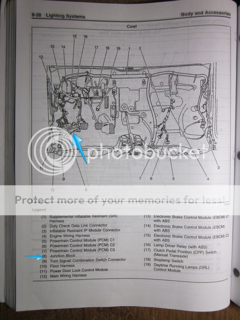

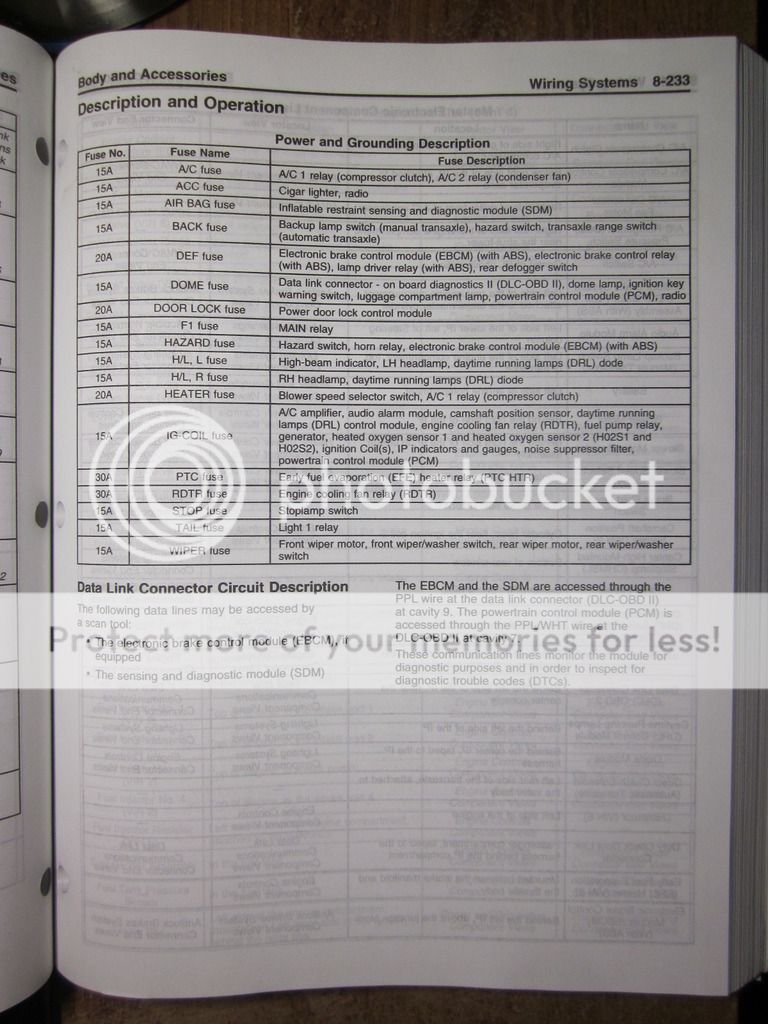

freegeo
Info from the 98 FSM. If you need wiring diagrams just pm me and I'll look them up.

thank you for the diagram but I'm still unaware of where exactly togo in the i checked the ones under the hood and their fine perhaps its something I'm missing sorry I'm a newby

You will find the fuses in the junction block (or as we call it a fuse box), it is under the dash to the left of the steering column, above were you left foot would be. Check the dome fuse to make sure it is good. It is a 15 amp fuse. It will probably be good since it also powers other things too.
