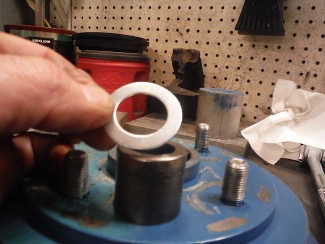

Solution? :hmm Shim the spacer. :thumb A 14ga machine bushing works great. ^o)

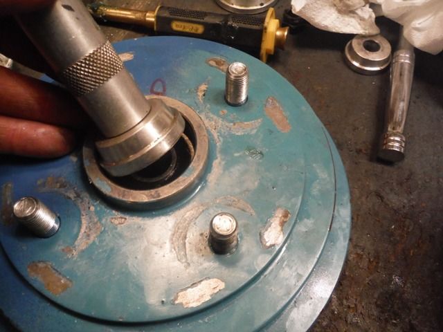

Use a Real Bearing Tool to press with. A socket will ended up giving the bearing pre-load. Pressing surface needs to be flat.

Pretty sure the machine washers are. :hmm But what if their not? :dunno It doesn't spin and doesn't have any real force, other than the 74ftlbs. :hmm I do know the machine washers are a heck of a lot more solid than the standard spindle washers, which squash if torqued too tight. :'(

74 ft lbs? I over tightened mine then because the Haynes Manual 1985-2001 Chevrolet Sprint, Geo & Chevrolet Metro Chapter 9 Brakes states that staked nuts are torqued to 129 ft lbs. I will adjust it down to 74 ft lbs. (thanks Snowfish) I will go ahead and get the 14 gauge machine washer from my local hardware "big box store" and see how that works.

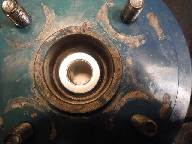

Hey snowfish. I tried the washer as a spacer and it didn't work. I think my aftermarket drum could be out of spec. It appears when I tighten the spindle lock nut down, the brake pads are causing too much friction. I can't even spin the drum by hand. Which brand of drum do you use? Where did you source it?

No I didn't. Now that I look at the pictures that snowfish provided, I realize that I put the washer in the wrong place. :doh
He is right about the bearings getting loaded up. As soon as I tighten the spindle lock nut down, the drum gets hung up and doesn't want to spin. I will get a bearing driver set and do it right.

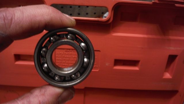

By not having the correct length spacer when you torqued down to 129 ft lbs you were pushing the balls of the bearing against the race at 129 ft lbs. That has probably flat spotted the balls and indented the race. I would suspect that you have less than 10K miles before the bearings go bad again.----Just something to watch for.
