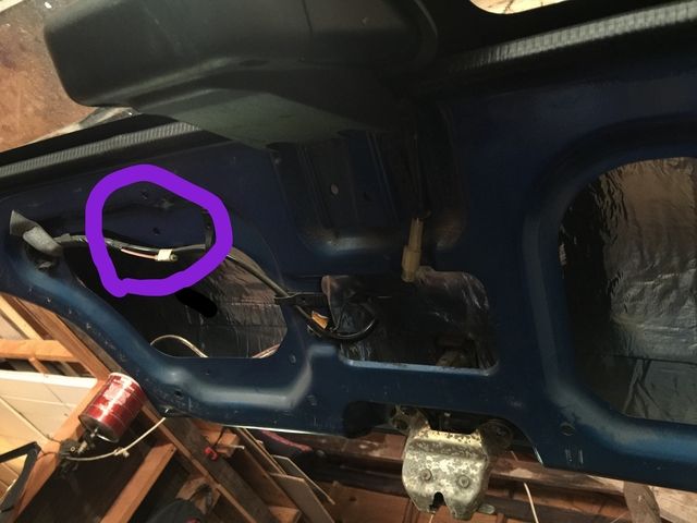

Can anyone tell me what this wire is for?

any way to modify it for a rear defrost grid, typical things concerning, right gauge for amps, where does it lead in fuse box ect.

Yes that is the connector for defrost. All '95+ Metro's are wired for defrost. Behind the third blank switch cover from the left, next to the steering wheel, you will find the defrost switch connector. All you need is the switch. Plug it in and your good to go.....there.
At the back of your Metro, You will need either glass with a defrost grid, or one of these aftermarket grids. Plug it into the connector your showing, ground out the other side, and your done. :thumb

Rear wipers were very Metro specific. Each Metro that had it, had a special wire harness. It is a real pain in the rear to add a rear wiper to a Metro that did not come with one from the factory.
