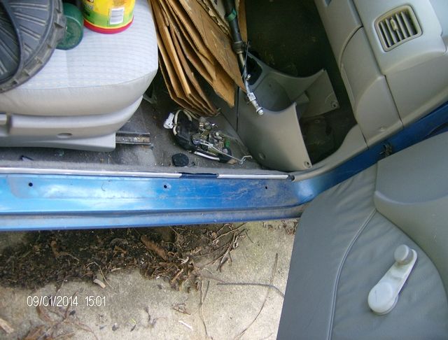

Inside the fender well. To show the lack of rust.

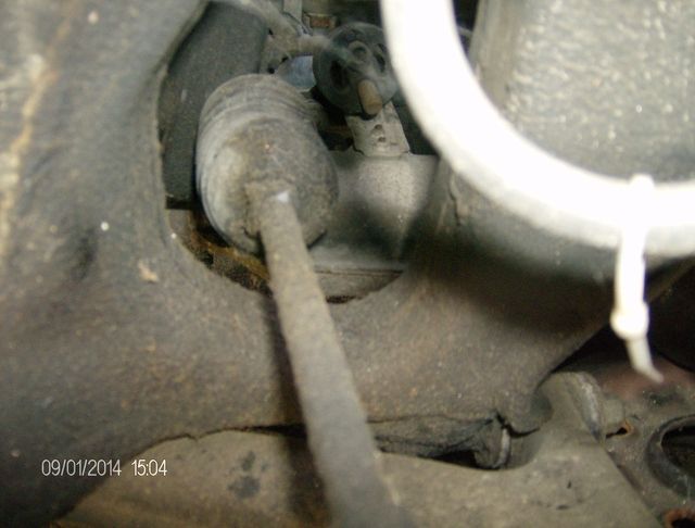

Frame horn.
Door frame

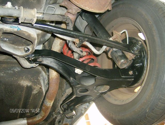

Right side rear suspension. Complete with lowering springs. Yes, a rear sway bar. I haven't quite figured out the mounting. I'll let you know what I come up with.

All I accomplished today was to clean and paint the left side rear suspension parts.

I finished the rear suspension yesterday. I used the suspension parts from the Swift, & the HR Lowering springs I have.
Pulling the parts from the donor made it easy to clean, prime & paint them.
They look out of place under the car.
