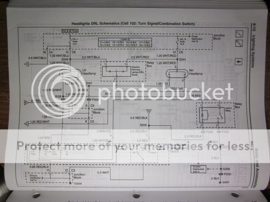

Hey folks,
First of all, I have read through all of mullet's headlight post :)
Low, high, and DRL all went out at the same time. The brights work with pull-to-pass. I checked all the connectors in the driver's footwell, and nothing looks burnt. I bench tested the relay, and it works. The relay clicks when I turn on the headlight switch, so I think the headlight switch works.
How likely is it that a dimmer switch would fail in a way that would kill both high and low at the same time? If the wiring on the 99 is the same as what mullet posted, then a bad dimmer shouldn't kill the DRL, right? Also, a bad DRL module shouldn't kill the high beams, correct?
Does anyone have a wiring diagram for the '99? All the colors are different than what mullet posted. Factory would be great...been burned many times by inaccurate Chilton/Haynes diagrams.
Any likely culprits?
Thanks!
Tom
freegeo

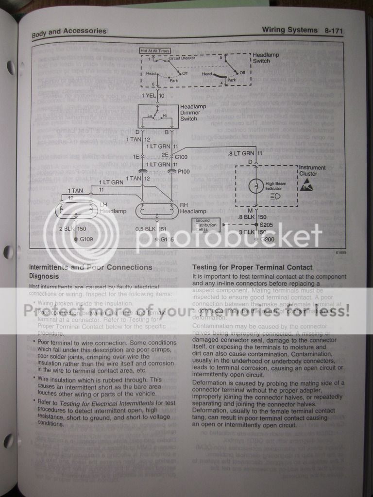

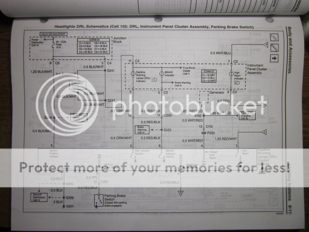

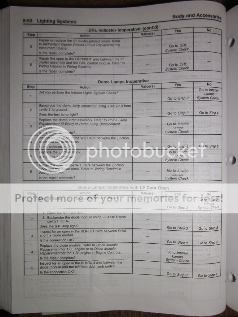

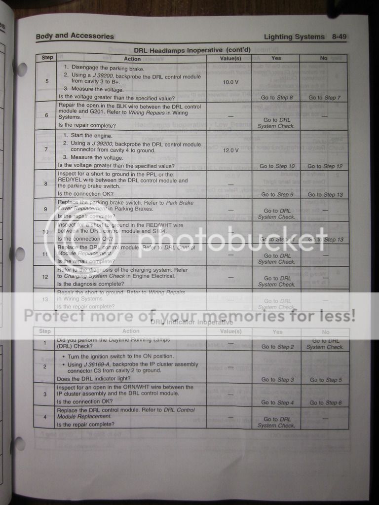

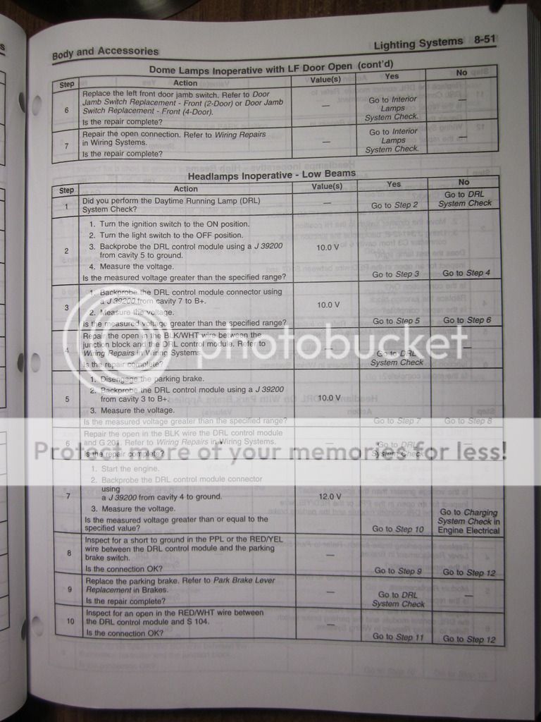

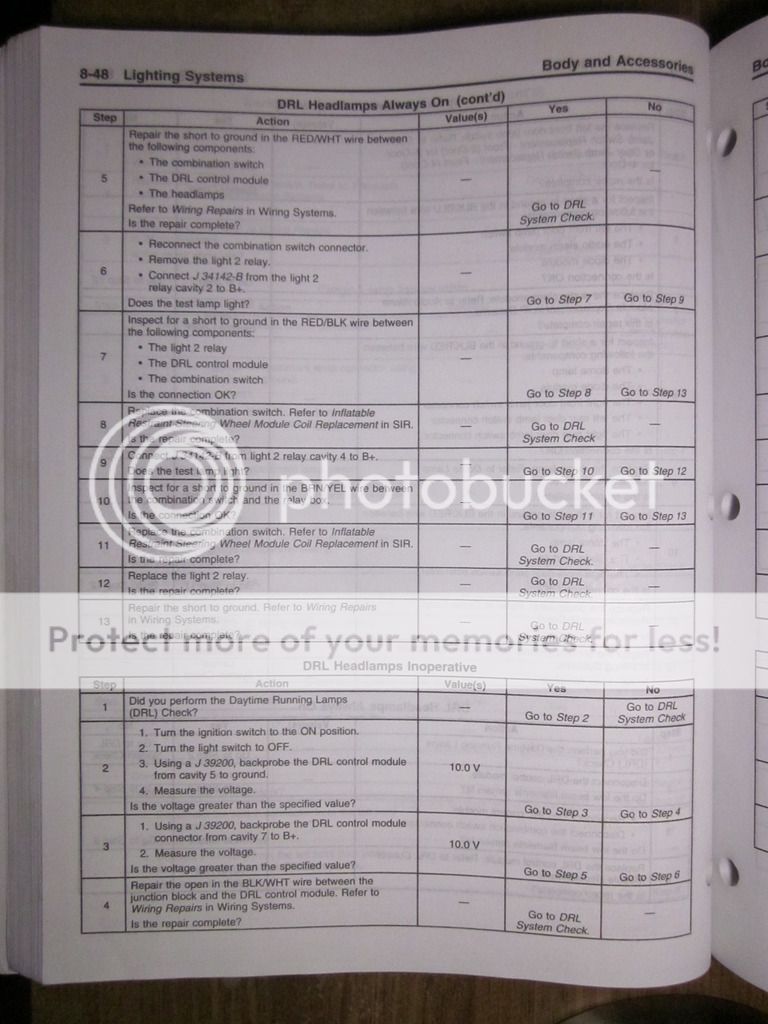

Found this in the 98 FSM, still looking for wiring diagrams. I'll see what else i can find before I have to get ready for work.

3-BANGER
Awesome! Thank you so much. That should let me dig right in.

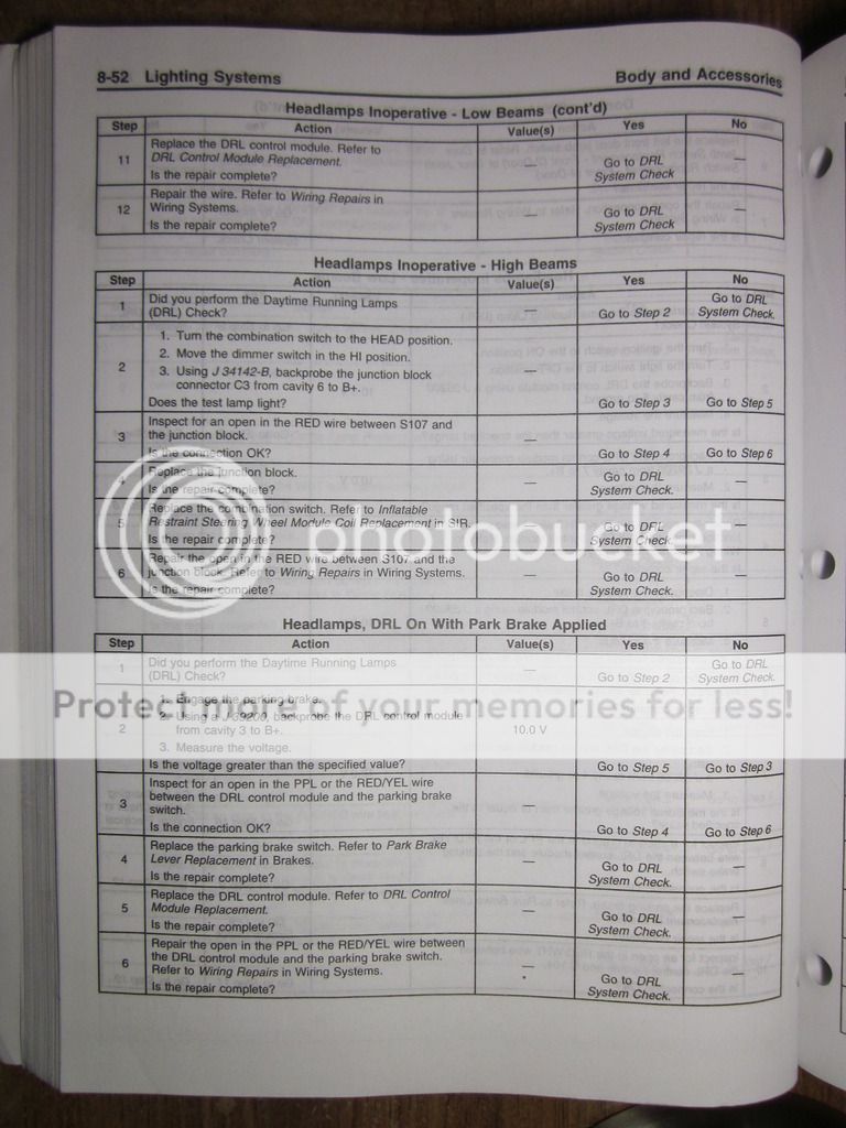

wahoospa
I'm wondering if the parking brake switch cause this?

ptcapboy
wahoospa
Oct 2 2015, 08:57 PM
I don't think so because I believe the brake switch is just tied into the DRL's- the headlights should come on when the switch is in the on position even with the parking brake handle applied
Mythstae
ptcapboy
Oct 4 2015, 06:03 AM
wahoospa
Yes, that's correct. ^o) :thumb
BobJ
The lights on my 2000 metro did same thing. Happened a few times when pulling out from parking space, then completely quit about half a mile up the road. I played with e brake a few times and they came back on (maybe coincidence?). Unhooked drl module next day and haven't had problems since. I didn't like lights on all the time anyways.
