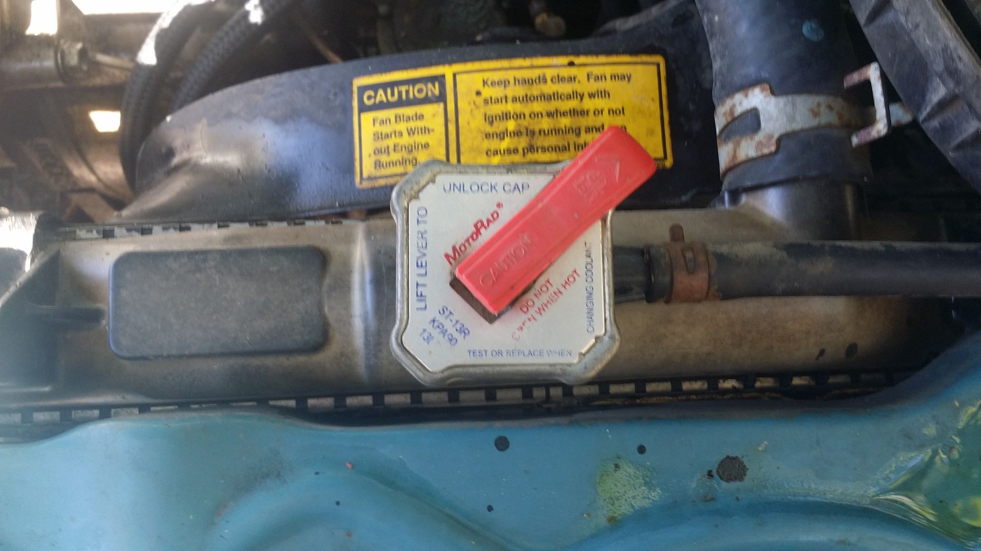

Replaced radiator cap with one of the pressure release tab versions

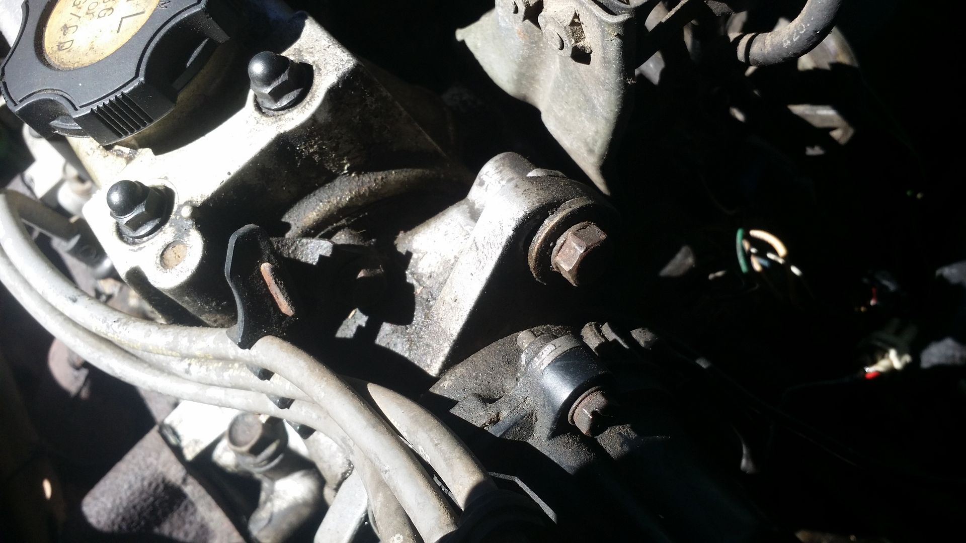

Reset cam timing with timing light. Idles at 800rpm and has quite a bit of pep.
Hood says to set timing at 5, but that almost seems a bit too low. Going to look on forum for other posts about it to see what others have tried.

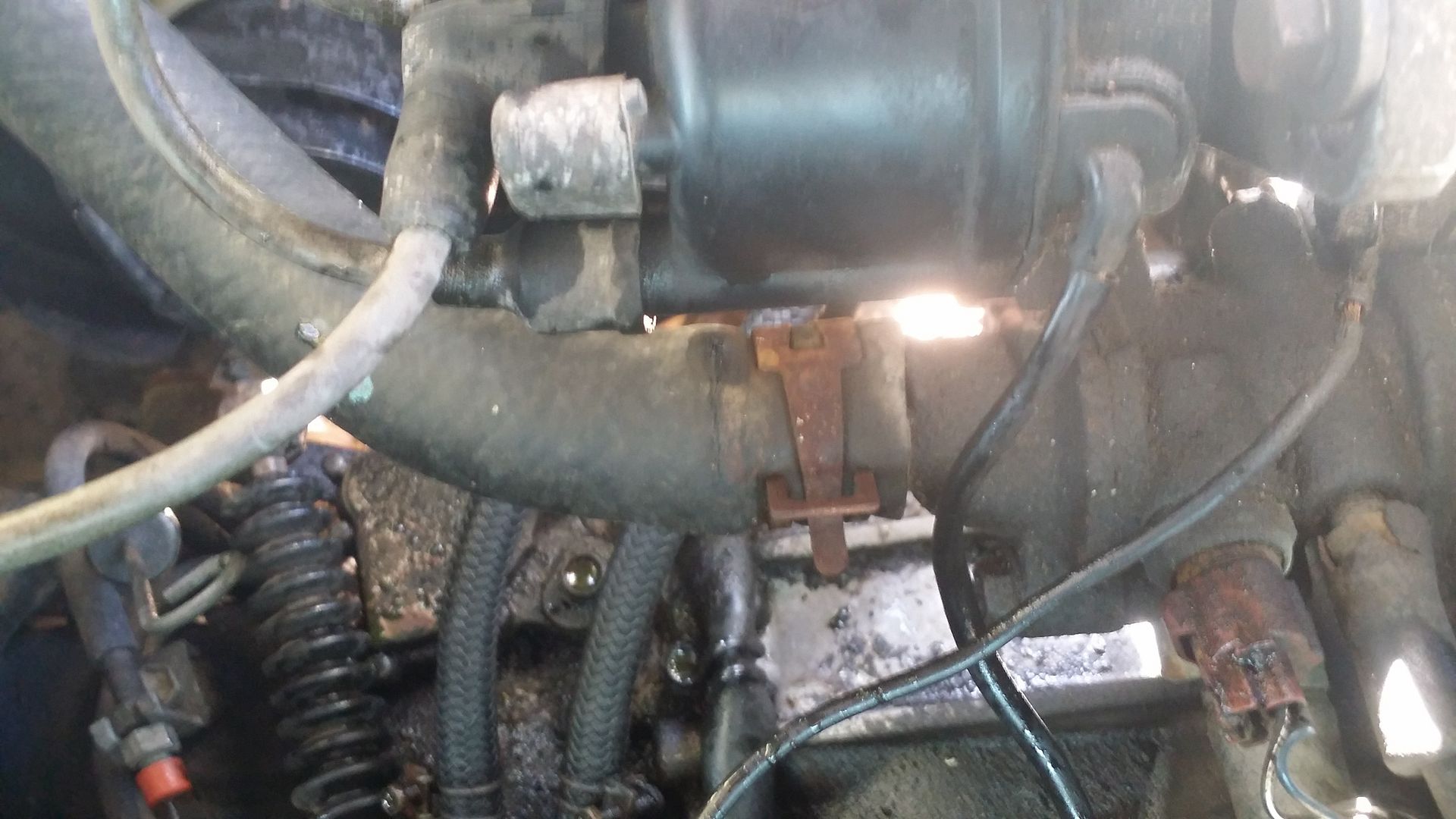

Leaky hose. You can see to the left of the clamp where it was just spurting out a mist of coolant lol
Cam timing set
Lever pressure release style radiator cap. I really like these
