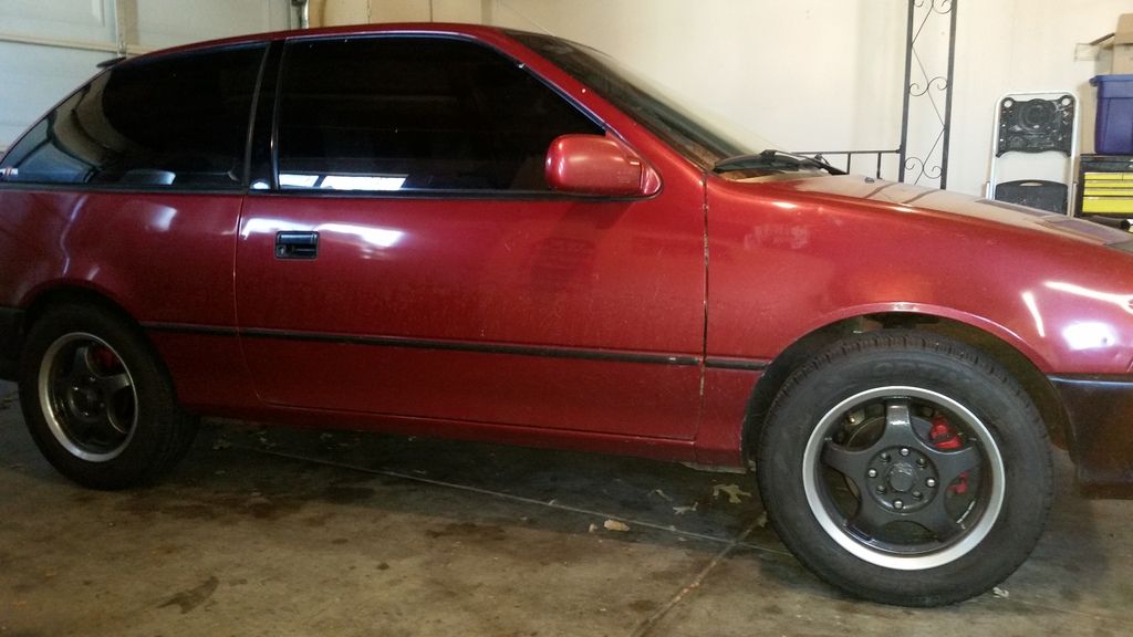

Ok well just my 2 cents. Cutting the coils is not ghetto. I cut 1 coil off all four of the ones off of a 98 Metro. I have no measuring equipment, but just pushing down by hand the 98's seem to be firmer than the ones off my 93. Don't know if that's because the 95+ are heaver. First off. I think its what you want to spend for $ on a suspension. When I did mine I ordered all new bushings, I was also adding front and rear sway bars. Bars came off of a 89 GTI. Also added front and rear top strut tower braces off of a 92 GT. Put in newish kyb's. If you are looking for ride and not as much body roll. I would go this route I have noticed a big difference. Mine is not slammed, but you get the general idea. Everything I have done as for my suspension I received off of this forum. Most members would tell you the same not unless you have a wad of $. I like the stance of my Metro and I didn't have to put alot of $ to do it.
Good luck!
Otey
Pic with the 14in wheels on.
