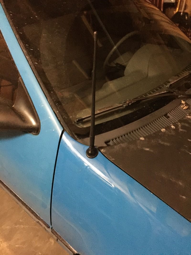

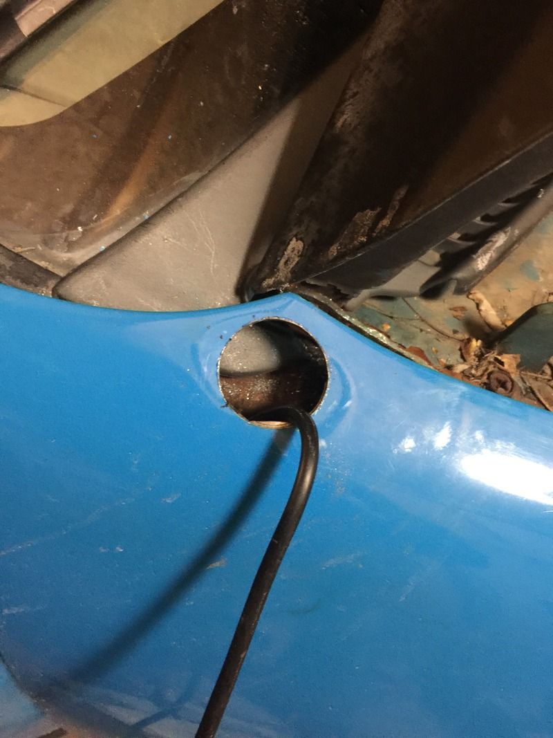

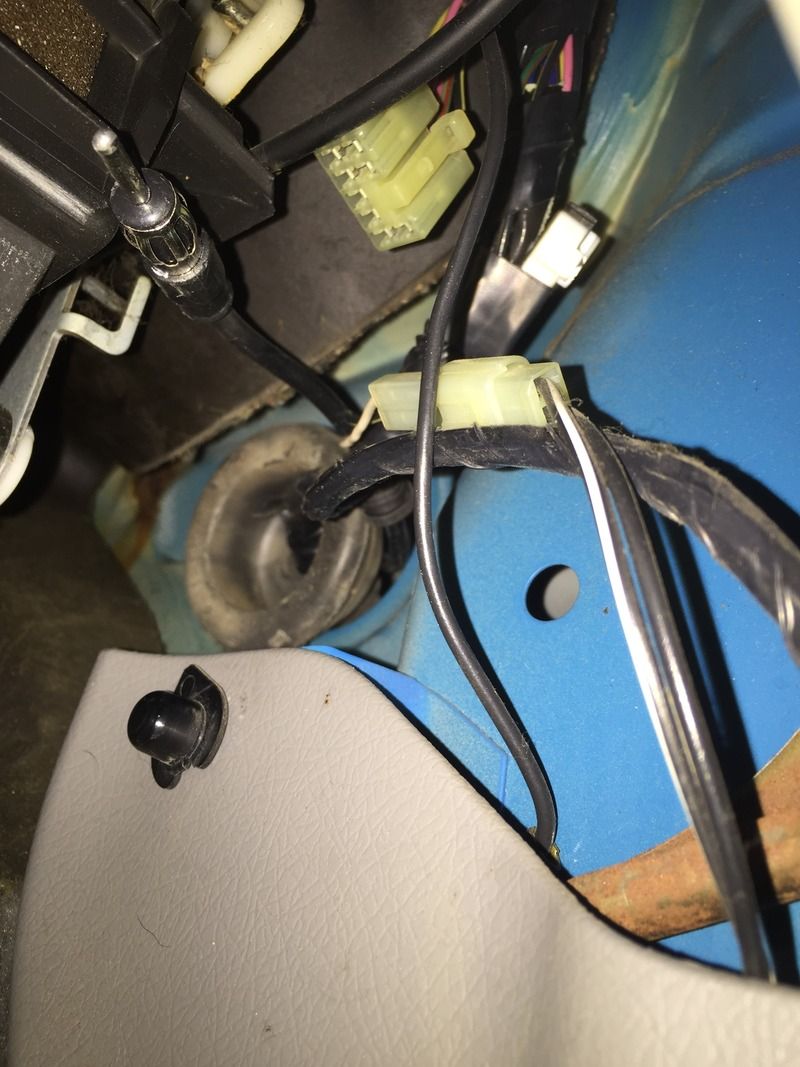

So I was tired of crappy fm reception in my car. Went out and bought a 9 dollar antenna from Walmart. Drilled a 1 inch hole on my passengers side fender close to the top of the hood. Inside the car I had a rubber boot with other wires going in between the car and fender. Popped the boot out and feed the antenna wire from the top of the fender to the inside of car. Put the boot back on and hooked up the antenna to the CD player. I was inside my garage and I was getting good reception to channels I couldn't before. Unhooked the other antenna from the top of the roof and wrapped it up under the dash. I'm going to just leave the top antenna alone. Very easy 9 dollar fix. ![]() ![]() ![]() ![]() |

I agree it would be better, but that would of been to much work lol. It works better then the factory antenna, that's all that matters to me. |
