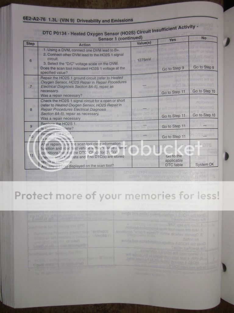

freegeo
This is from the 96 fsm. For the 1.3. Read through it before doing the steps in the procedure.
thermo44
Thanks everyone I'll check out that ground tomorrow
