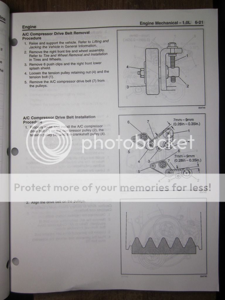

Does anybody have any accurate diagrams or descriptions of all the different pulleys and what they control on the belt system of a 2000 chevrolet metro automatic sedan with A/C.... trying to finish fixing a problem and need to know this to fix it

Are you talking about a 3 cylinder or 4?
Most auto sedans are 4 bangers...
hj00restore
4 cylindet
freegeo
See if this helps. If not I'll look some more after work.
