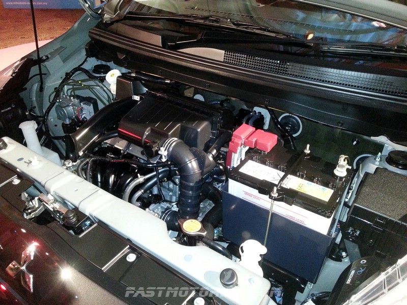

Also, a couple more questions about the Mirage. It seems the reliability is pretty good from the experiences are here. How is it to work on?
1. Basic services like oil changes and coolant flush.
2. Getting the battery out. I hate cars where you have to remove a wheel to swap the battery.
3. Stuff after the long term like water pump, etc.
4. Is this engine belt or chain driven? If belt, how hard is it to change?
Conor
1) Oil filter is on the front of the motor, but the cooling fan is in the way a bit. Easy to get to from the bottom, a little trickier from the top because of the fan. One of my favorite features...one of those 'little things' I like about this car...is there is a small spout underneath the filter. Instead of oil oozing down the side of your block when you remove the filter, it runs down this little spout and into your catch container. It's genius, and all cars should have this!!
2) Battery is right up front, and on top (see pic). Held down by the standard battery clamp. Should only be a few minutes to remove, but I haven't needed to. Odd thing is that it isn't the maintenance-free type we all know today. It's old skool...with the little removable caps!
3) Water pump is driven off of the serpentine belt, and should be as easy to remove as a Metro's. It is also right under the alternator, which should also be easy to remove. With the Metro the water pump is on the back (firewall) side of the motor. It's on the front (radiator) side with the Mirage. Looks like about six little bolts hold it on, and there are no hoses to remove. The thermostat is right behind the water pump in a separate housing.
4) Timing chain. Take the oil filler cap off and you can see the top of it. Should last, well...forever.
This motor should be really, really, REEAAALLLY easy to work on. All that is on the back of the motor is the exhaust manifold. Everything else is right up front. In the pics you can see the tiny little Mikuni throttle body, and all of the sensors. Remove the big black intake box on top of the engine (couple bolts) and all of your plugs and coils are right there.

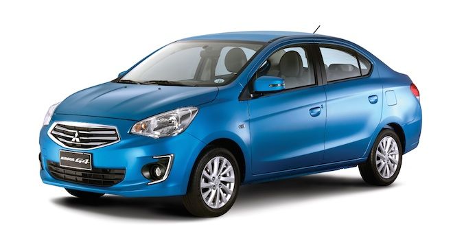

The consensus here seems to be that people don't like the cheaper style of the Versa... on a Metro forum... the irony! :lol
The cheapness and basic features were my favorite part of the car! Not to mention, a newer fairly room sedan, 5 speed, with high 30's MPG. You'll never find that (at this price point), unless you shell out a few thousand more for a Mirage (or find another NOS barn-find Metro... :lol )
The Mirage really isn't 'a few thousand more'. My girlfriend's was $11,800...brand new. Deals can be had on both that make them about $12,000-ish. The factory rebate on the Mirage is $1500 right now. I don't see any rebates or factory incentives on the Versa right now.
MSRP on the base Mirage is $13,800, MSRP on the base Versa is $12,800. But, IMHO, you actually get more with the Mirage (auto climate control, power windows, etc).
Again, I don't dislike the Versa. Nissan sells a lot of them for a reason. But this is a forum dedicated to 20-year-old 3-cylinder economy hatchbacks...there's no reason a NEW 3-cylinder economy hatchback shouldn't raise a few eyebrows here. :lol
Did you drive the Mirage?
Edit: I did a little research, and Nissan has a LOT of problems with 'piston slap' on that 1.6 motor.
I have not driven the Mirage, and have no clue where the nearest dealer is. However, I would like to drive it. I don't dislike the Mirage, but I am not a fan of new-style hatchbacks. I prefer the look of sedans, even though they have less function. Call me weird, but the auto-climate control and auto windows are the exact thing that annoy me with the Mirage and newer cars... I am very loyal to basic 20 year old economy car styling! Even the bluetooth controls (standard like A/C on all new Versa models) on the steering wheel drive me bonkers! :lol
Edit: I haven't heard of the piston slap issues, but I'll have to look that up.
