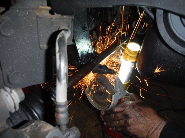

PTA2PTB
It's extremely common on these cars, for the "tube" to stay behind once you wrestle the control arm off the spindle.
I think what a lot of people do, which is what I did when I did both of mine, is take an abrasive wheel cut-off tool, and, very carefully - so as not to cut into the actual spindle, cut a slit in the tube running parallel to the shaft. Don't cut all the way through it, just cut into it about half-way. Then take a cold chisel and hammer and whack it. That will split it open so you can pull it off with pliers. Then clean up and lube the shaft before installing your new control arm.

The metal inside of the front brushing stuck on the spindle; on both sides. I managed to get both of them off with a grinder, and installed the new control arms. I left the stock black rubber boots on, because I couldn't find the orange ones anywhere, and I need my car now. I still have to replace the front struts in the spring, so I'll upgrade the boots then. Do you need the metal spring/tie things for the orange boots?

Wowza, Snowfish! :O
That's a monster angle grinder... you should have seen my tiny cut-off wheel... it is about an inch and a half in total diameter, and the rotary Dremel tool its self is smaller around than my fist... :lol
