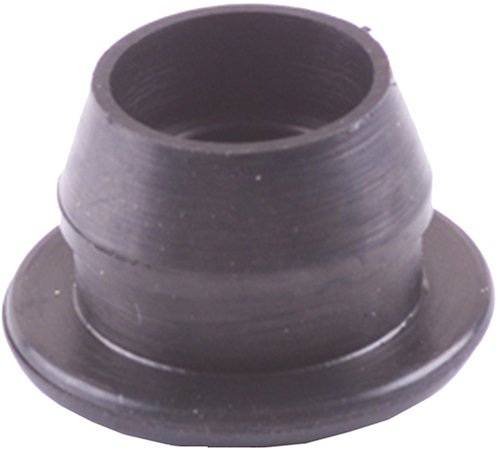

I used a PCV gasket to hold the boot under the shift knob. Something along these lines
amazon link
