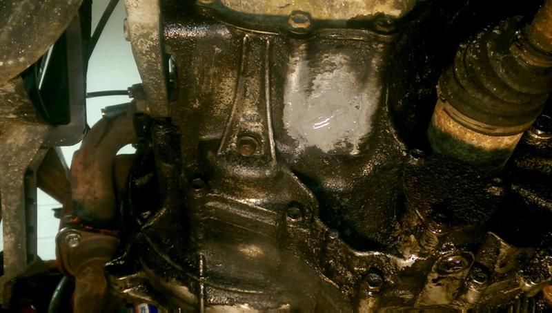

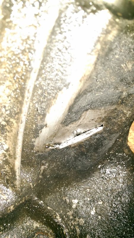

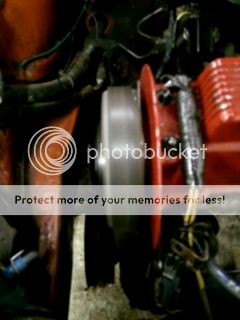

Thank you for everyone ideas and support.
Here is a pic of first layer of jb weld

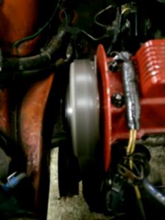

So with great many thanks. We have the final result of the geo trans crack repair......
IT WORKED!!!!!!!!
702852
I have to upload pics, but in a nutshell. I cleaned the area with a bar of soap and water then scuffed the area with 25 grit paper and used two layers of jb weld. The red and black tubes with a 30 minute break between layers.
The car sat jacked up for 3 days and today I filled up a quart of synchromesh on top of what was left over and drove the car same way with hard braking to make sure the oil sloshed around and not one drip from the jb weld repair. So mucho thanks gang. And pics to come.
