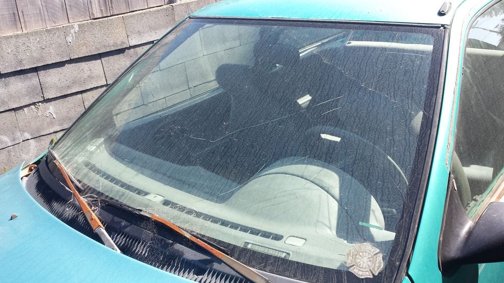

I have done a lot so far. This is not the most recent pic but its looking a bit better with the windshield replaced
Getting it registered in CA as an EV is really easy. Once it is ready for the road, you just make an appointment with a smog referee, and have him do the inspection. The inspection is really easy, since he just looks to make sure that your ride is electric only. No place for gasoline, no evidence of having a generator. Once he is happy that you are electric only, he gives you the same smog certificate as the one you get for your gasoline cars, but it will say pure electric on it and be good forever. It is also free. Take that to DMV, and register it like any other Metro, and you will never get a smog request from DMV ever again.
