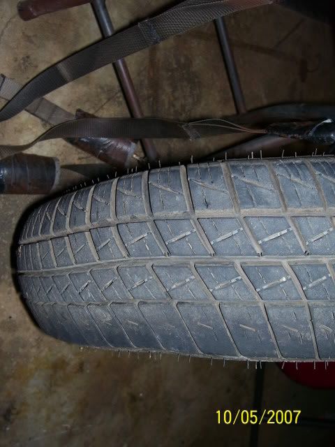

well yesterday i was able to replace the cv axle. i noticed that it felt extremely loose on the end that connects to the wheel. after i was done i was putting the wheel back on and noticed the wheel is warped... like badly. here is a picture to give an idea what the tire is like... this is not my picture, i didnt get one because my phone was dead and my digital camera is messed up.![]() After I noticed this i put the tire back on, did a test drive to see if the noise i was hearing was gone, it is. obviously the car still pulls to the side. tomorrow after work i plan to take the car to get new tires if i can afford 4 new ones, if not i may just have a used tire put on until i can afford all new tires. |

That tire is messed up. |
