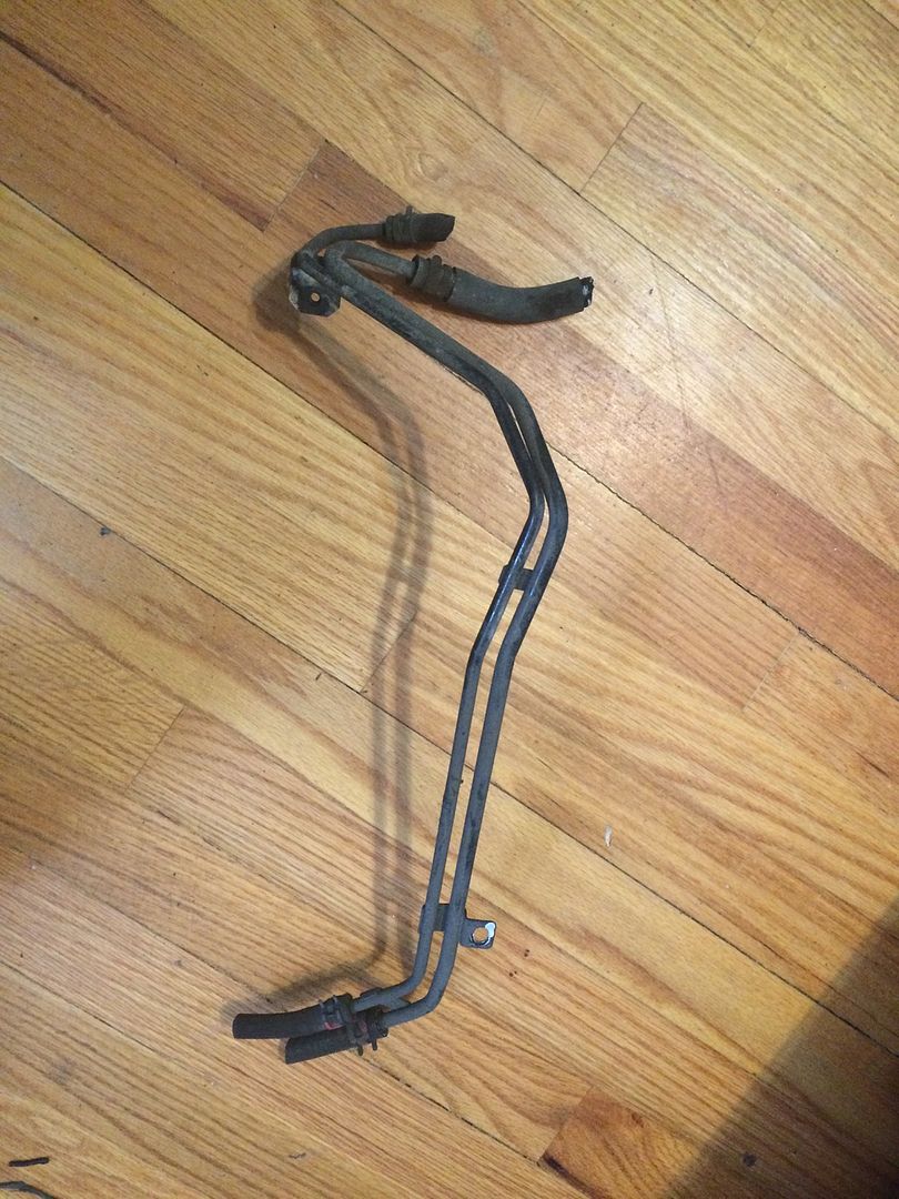

I have raw fuel coming back up if I pull the gas cap off it stops coming through the charcoal canister
suzukitom
Tom
I have been starting to write up a gas tank replacement post, (which is incomplete), but it seems you need something to look at right away, so here is a picture of the tank hose routing.
ChadC
Thanks! I got that much I have the tank in I think I just had two line flipped. the lines being the vent and return fuel line, I just flipped them back and I'm going to see how that works.
suzukitom
Tom
The two parallel metal lines from the tank top are fuel + return lines.The rubber line by itself is the vent.
