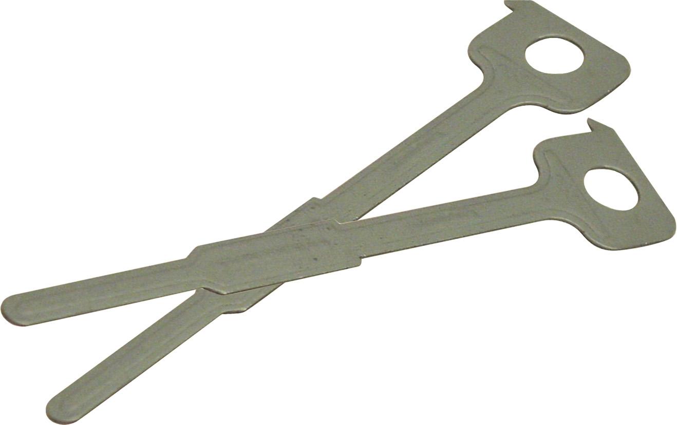

You need the removal tools, like these. If you can wait a day or so I have a couple I could drop in the mail to you. Shoot me a pm with your info if you want them. |

There are 2 flaps on the sides of the deck. These tools will unhook them. Their in the mail. |

Here is a pic of the deck cage. I must have thrown out the last deck I had so this demo won't be very clear. You can see the flap that goes down the middle towards the rear of the cage by my middle finger. ![]() Here is a pic of the tools again. You put the tools down inside the slot all the way that they go and push the deck from the rear and it should slide out.
