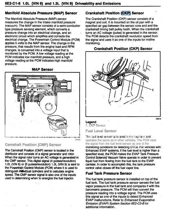

This is from the 97 FSM. Looks like the 4 cylinder is the same as the 3. Just like the picture posted earlier.

If your engine is supposed to have a crank sensor there should be a half round indent in the oil pan like the picture shows. What valve cover is on it ? Aluminum would be 95 on up and if it's a stamped steel one it most likely came out of a Suzuki Swift. Ken....... |

looking at FSM book 2 1996, page 6E2-A1-3, it looks to be the same location. although looking at same book, pages, 8A-201-0 + 8A-201-1, it is not pictured for 3 cyl (8A-201-1) and 4 cyl is unclear. I remembered reading it somewhere, finally found it, Haynes, page 6-6 paragraph 20, gives different locations. I do not have a 4 cyl here to check. I am beginning to think that the CKS has been removed..... crvett69's picture is a good pic. look in that area for a "hole" that the sensor should be in. Edited by sphenicie, Mar 30 2016, 08:37 AM.
