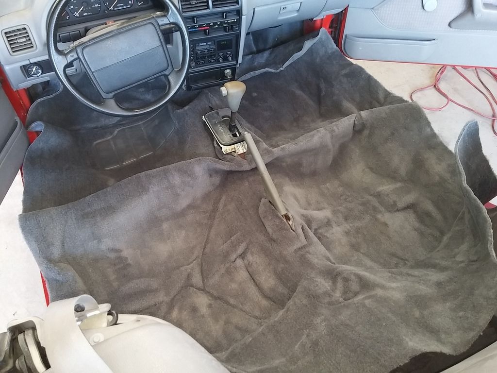

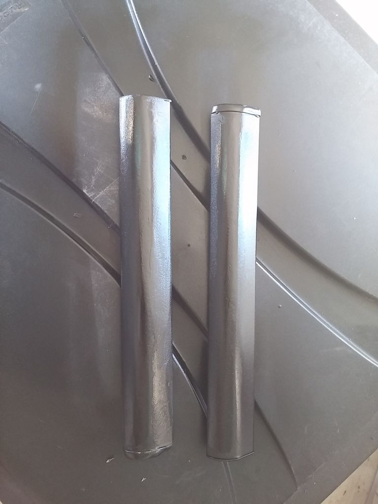

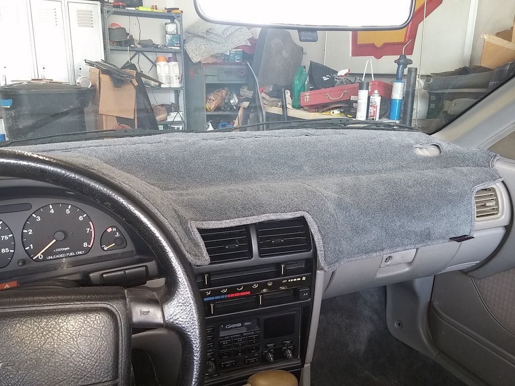

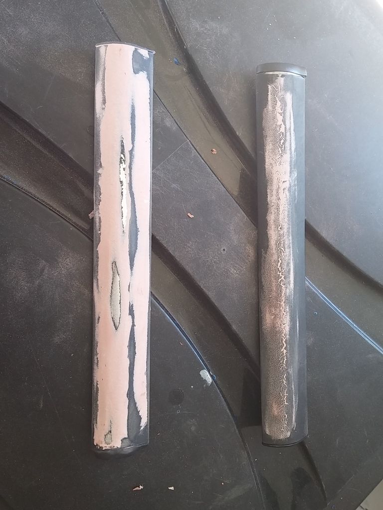

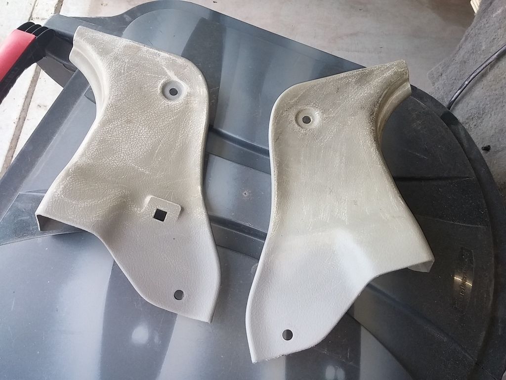

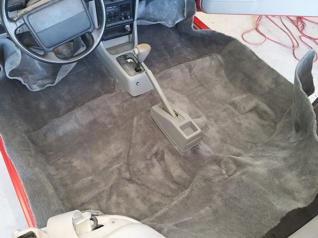

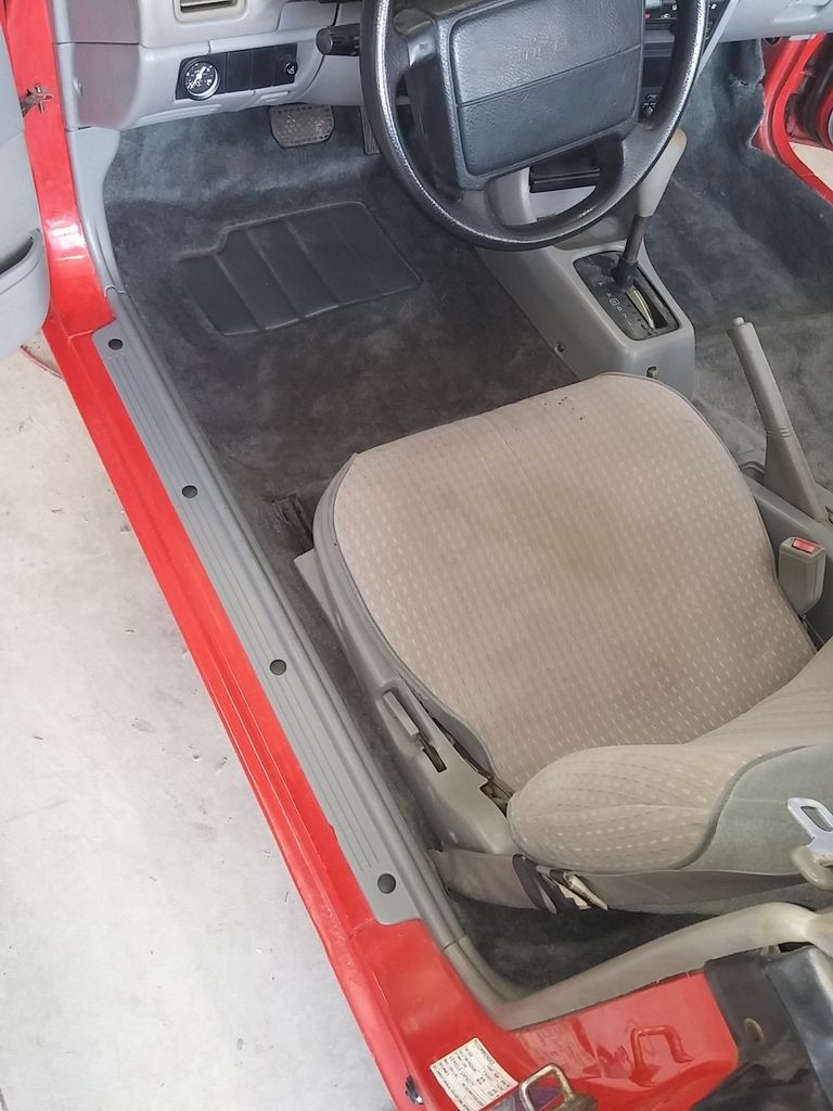

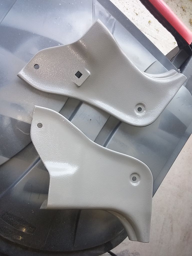

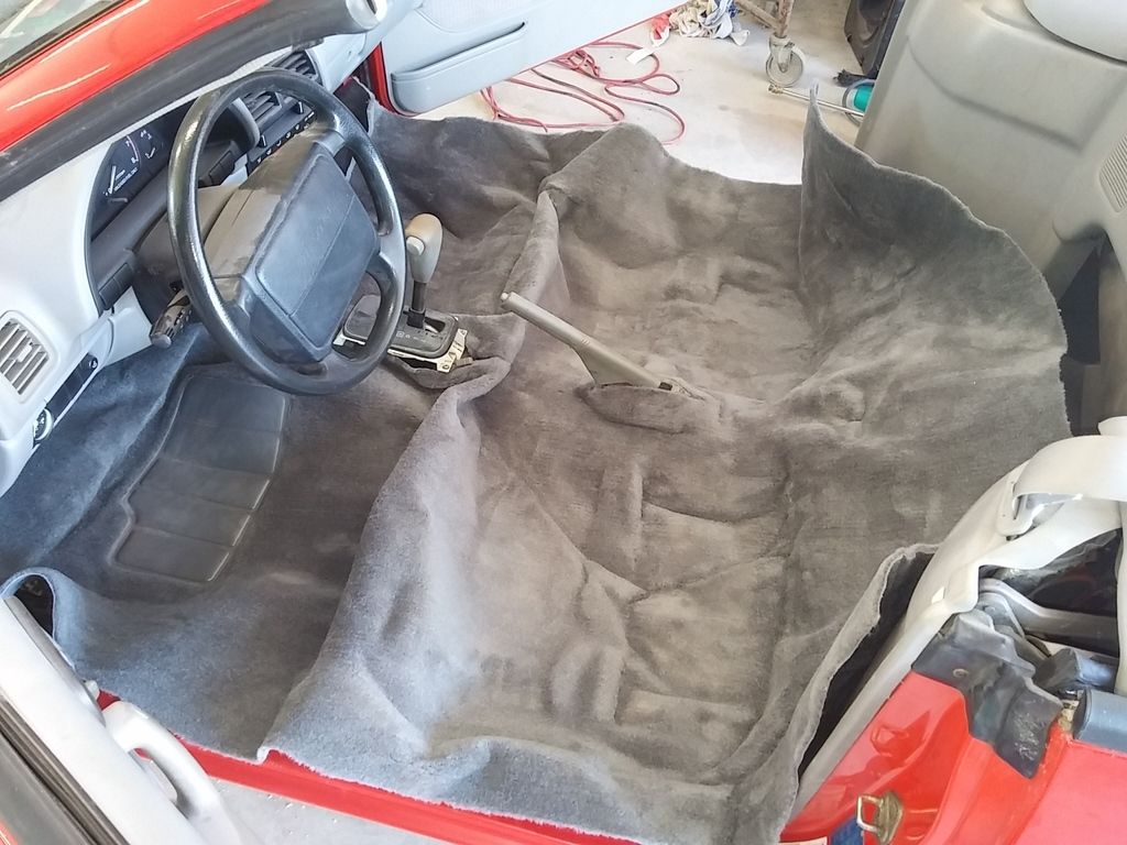

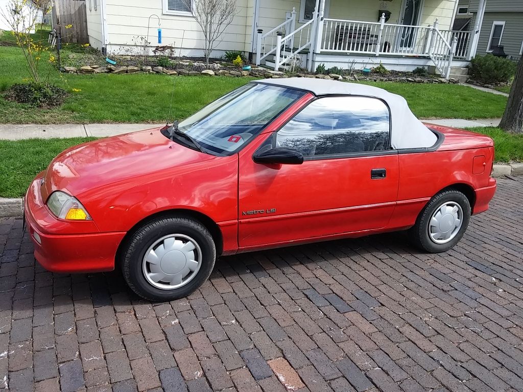

Today I finished getting in all the carpet, dash pad (the dash was cracked pretty bad), seats, and interior trims. I was able to find a trim paint that matched perfectly the original color of the plastic molding.

So that can of trim coating matches the Metro interior color? I think I need to grab a can or two!
I believe it will for your 92, yes. Use a wax and tar remover, wipe it down really well, then rough it up a bit with fine grit sandpaper.

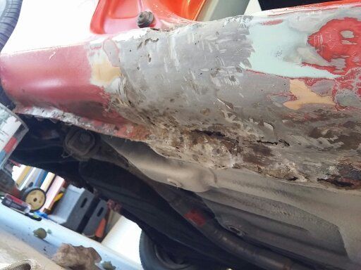

Nice post. I'll have to pick up some of that interior paint for my vert as well. Your weld-less rocker repair turned out much nicer than a rocker weld I recently attempted.

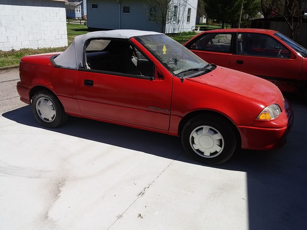

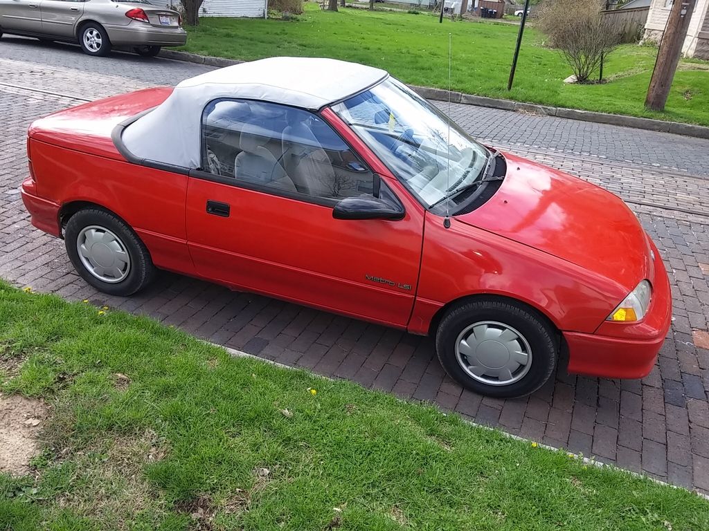

The car is actually for sale. $1800. Columbus, Ohio area.
1992 red Geo Metro convertible with gray top, Columbus, Ohio, $1800
