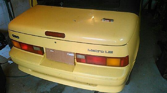

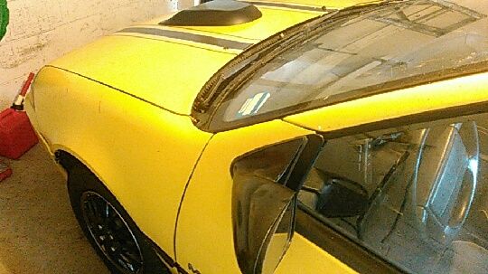

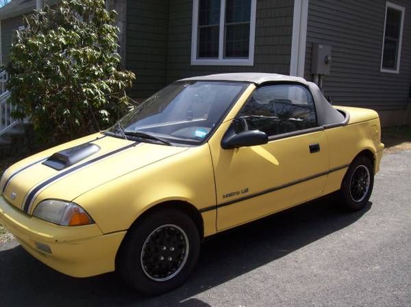

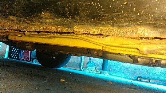

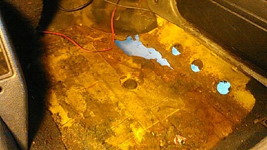

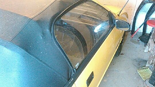

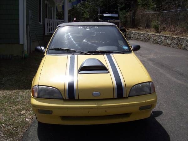

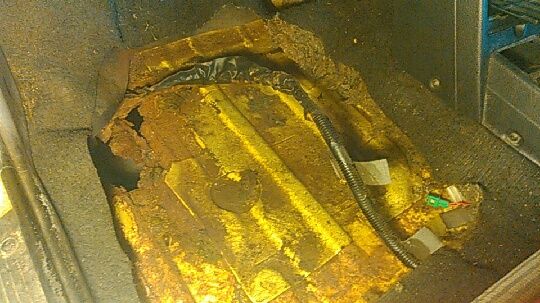

My Geo. This car is a reincarnation of a 1982 VW rabbit to which was a great car that had less blemishes than a 8 year model old car on the road today. Unfortunately I had to get rid of it. Now its in scrap heaven. I went up in Connecticut to get this one saw she had silver brake lines and drove her 500 miles back home. I swore a blood oath to restore her. Bodywork would obviously be the first place before anything else. This cars an oddity, whoever owned it kept up on the paint because there isn't a single blemish but the underbody needs work. I believe the frame horns will probably need some restoration as well i did not look closely. As you can see in one picture the drivers side pinch weld completely separated from the rocker panel. The passenger side rocker panel is rotted away.

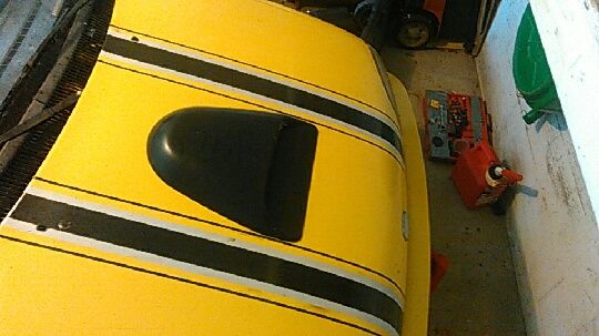

Nice looking car. thanks for sharing. Is the hood scoop OE?
No thats custom work done by one of the previous owners. Like i said this cars has been givin much care and attention over its years but it has neglect too. I think the scoops rediculous lol maybe ill make it more functionable down the road.

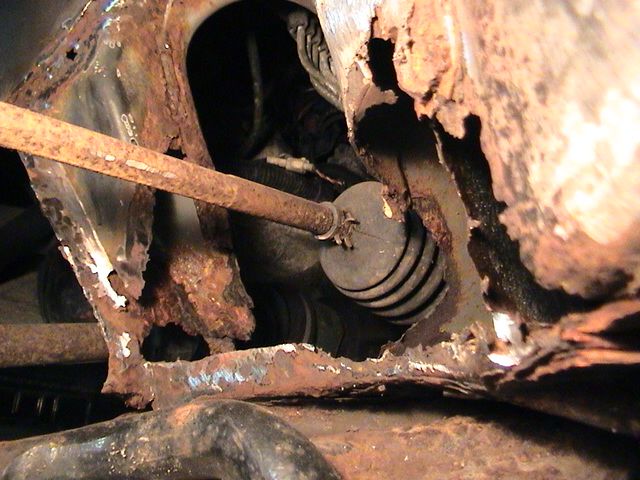

Those are actually the strut towers, which do look great by the way! Better than the ones on my South Carolina XFi. The frame horns that we are referring to are down lower under the the strut towers up front. The CV joints from the transmission to the wheels pass through them. Nothing really to look at in the rears.
This one looks fairly clean:
This one is REALLY scary:

Haha, thank you, i know quarter panels, subframes, and rockers, thats the extent of my body knowledge! When you told me those weren't the moneymakers i cringed, but luckily i crossed my fingers said 'no whammys' and hit the stop button and got lucky again! Here's those Horns. Whoever did the 'repaint' did a good job on this thing. The engine cab looks cleaner than some of the new cars fellas i know are driving. That bottom horn picture almost turned my hair white lol. Sorry i didn't embed them properly i don't know which link to use. http://s1070.photobucket.com/user/tfox888/library/Geo/fram%20horns

Looks like you have a good set! :thumb
However, they rust from the inside - out. Lots of members on here recommend using one of the small holes that the plastic wheel wells pop into to feed a hose in and spray the inside with rust converter, such as Eastwood's Internal Frame Coating (linked below). It's not cheap, but it does the job well. Others have told me that you can just squirt used gear lube around the inside liberally to coat the whole thing. One way or the other, it is recommend to coat the insides to preserve them for future years.
I haven't done mine yet, but I will be soon, and have a can at home. Not sure how many cans it will take, but one ought to do it if you go light. It is especially recommended in the area the we live in... My convertible sure won't be seeing any salty winters with my other cars on hand. Good luck!
