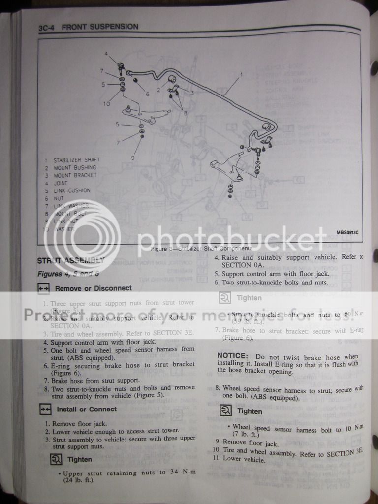

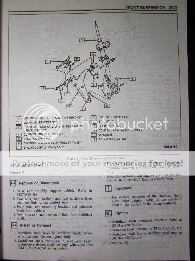

| freegeo | Jun 27 2016, 10:29 PM Post #4 |
I will check my 96 fsm when I get home and see what it calls for. |

I would recommend getting one. They are year specific and have lots of info in them. A little hard to find stuff at first but the more you use it the easier it gets. |
| freegeo | Jun 28 2016, 02:20 AM Post #8 |

| snowfish | Jun 28 2016, 11:19 AM Post #10 |
The sway bar should have a flat, to place a wrench, so the shaft doesn't spin. Mine are torqued to 20/38ftlbs respectably. The bushings need to be pretty tight to keep them centered in the recesses.
