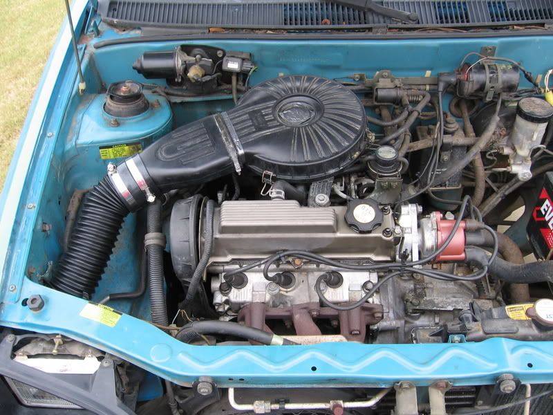

Ok, this one is out of the pages of the weird. I have found that adding this did not hurt my mpg, but did give little more power on demand, and has kept my air filter clean for a long time. This is important due to the cost of our filters...
I have experimented with air intake and it seems no matter what you do, you still have a 55HP engine ;)
I see you have not found a timing belt cover yet.

Will
Victory is mine!!!!
That's an older pic. I found one, but it was older and did not clear the belt. I kept it on enough to set the timing then had to take it off again. The search continues...
I will say that it is amazing how quickly a timing belt can chew through a plastic cover. HA HA HA :D

should i do something like that to mine or does it make any changes?
Will
Victory is mine!!!!
I did that before learning anything about getting higher than EPA mpg ratings on cars, so I do not have any test data showing any kind of real improvement. I found it most beneficial in the time right after my rebuild. The car developed several oil leaks, which I had to chase down. An air filter for a Metro is about $15.00, and I had this vent, so I put it on. It kept the filter clean while I chased down the leaks and fixed them. You may or may not have that same problem. I left it on there afterwards because I think its cool. That and it still seems to keep my filter cleaner. I just open it once a week and shake the dead bugs out.
Johnny is right though, it is still 55hp. Also, if you are looking for max mpg I would not suggest this. It makes the air colder and denser. This could increase fuel requirements.

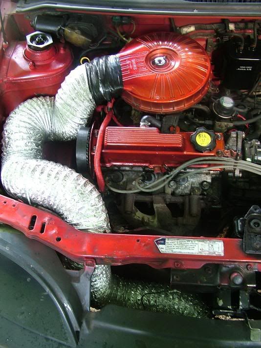

Here is what i did on mine...
I noticed a good improvement with this. The first time i went to the track i ran a 19.2 @ 68.5mph. However, after i did this i went back and in the same conditions i ran an 18.9 @ 69.3, i had the same 2.4 60ft both times.

SeattleJeremy
Here's another way to do it.
This was for my Grand Am using the aluminum dryer ducting. It stays in place better than the Bendable stuff, but it needs to be sealed at each connection point :)
