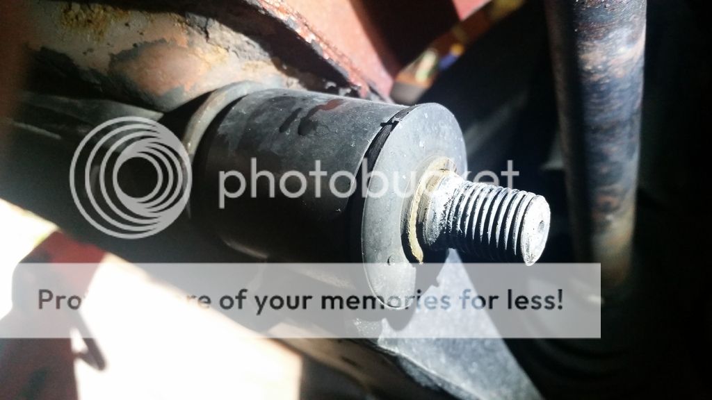

91 3/5 with 13'' wheels and tires. Been hearing a clunking sound from front end when going over bumps in the road. The car steers straight even at 80mph with no steering wheel shake. Wanted to know if I should swap tie rods or what to start with? I'm suspension illiterate, but am good at instructions. |

Just had the same issue. I had 2 bad tie rod ends, which wore out and end link pretty bad. New tie rod ends fixed the clunk but my drivers side sway bar link was the issue. |
