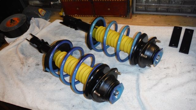

when i build my strut assemblies i use hard polyurethane as bump stops to replace the foam types they use as oem replacements. i like 80a shore hardness polyurethane as it is extremely rugged and doesn't disintegrate like the foam bump stops. these would work if you doubled them up.
http://www.ebay.com/itm/Energy-Suspension-9-9530R-Round-Polyurethane-Pads-1-1-2-OD-7-16-ID-3-4-HT-/131091004725?hash=item1e85a1fd35:g:aJQAAOSwZVlXrjs6&vxp=mtr
a little harder to find, i typically buy a cast poly cylinder so that i can use a saw to cut it down into custom lengths of about 1".
http://www.ebay.com/itm/Urethane-1-ID-x-2-OD-x-23-Tube-80A-Durometer-Orange-Polyurethane-Acrotech-/291853871645?hash=item43f3d8aa1d:g:oZ4AAOSwHoFXvF~p
