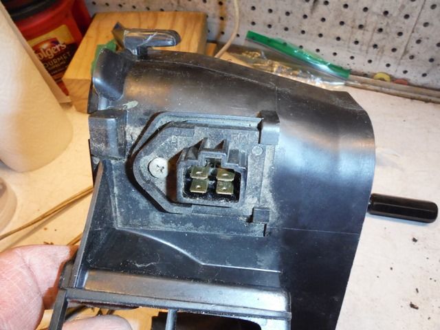

Here's the resistor block with the connector removed. :news
Here's what the working resistor coils look like. :news
Let us know what you find. :popcorn

Think charcoal crispy/burnt in half. There are two separate wires that look as if they were wound around a skinny pencil - they should be intact.
Do I have to remove the ECM just to get to the resistor?
No. Now please just go get started.
I looked and I can't find it..thats why I was asking.calm down

If you removed your glovebox, look to the left, you'll see a plug with wires plugged into it, can't miss it..
Go sit in the passenger seat, scoot it all the way forward so your feet are jammed forward practically into the firewall. Take note where your feet are, Look at the black plastic tube your left foot was resting on/just under.
It is above the passengers feet. Held in place by a single screw and has an electrical connector going to It with 4 wires in a single connector. Unplug the connector, remove the screw, remove the old one. A stubby screwdriver helps a bunch as room is a bit snug.

Got it out but i have no idea if its bad...i got pictures cause i have no idea,one of the soldering points isnt connected so i dont know if that means anything.
https://goo.gl/photos/ywDqLcrhNjaAaDZP9
https://goo.gl/photos/NXgYcLzY5pVgXF2t7
https://goo.gl/photos/8bindf8gPTXqrz1R8
https://goo.gl/photos/U79haJu74zwvgA5W9

Well the windings look good, but you won't know for sure till you do a continuity check on em.. Continuity good, no continuity bad..

the pix of your resister look good, but I could not see the spot that you said the solder connection is bad.
