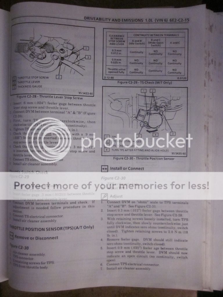

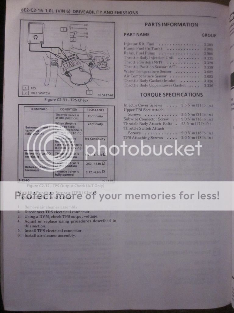

| freegeo | Nov 9 2016, 11:59 AM Post #16 |
Sorry it took so long. Do the check and don't adjust anything if you dont have to. There is a service update for resistances. You have any questions please ask. [UR=http://s1306.photobucket.com/user/pappasteve/media/001_zpsaovyrnrv.jpg.html] [/URL]![]()
| houdini0118 | Nov 18 2016, 12:18 PM Post #17 |
Hmm so i tryed that and got it all adjusted and it does idle lower now. Also replaced the spark plug wires and checked the timing and it was good. Still not working though. It seems to work correctly for ~30 seconds after i start it but then it goes back to the pulsing thing. Any other ideas? |
