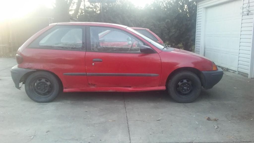

dang i was wanting to lower the front of my metro by cutting the springs also. i really just wanted to make it level or a little lower than the rear of my car. this is what im working with.
what about mabey putting a torch to the springs?
It almost looks like you have broken, or collapsed springs on the rear. Everybody wants to lower their car. I'd like to find brand new oem springs to install on mine, and get that nice Cadillac ride back. Lower rides, usually mean rougher rides.
IrishManson
Im pretty sure they are broken. Is it hard to replace them? I have decent ones on my parts car that i can swap over but ive never done this before and i dont want to hurt anything or hurt myself. I have all the tools but not the know-how
