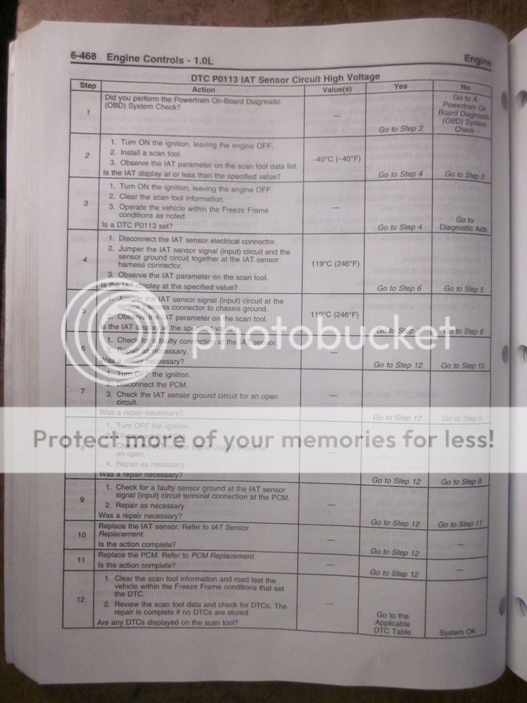

Well my engine light was on since i got my car and never paid attention to it since the car run like a champ 34mpg running all the time with A/C seems decent for me.. anyways recently i serviced the car changed plugs,cables, water pump, oil pump, oil, filters.. and decided to run a scan on the car and ended up with 3 codes... P0113 , P0111 and P0136 plz help |
| freegeo | Nov 15 2016, 11:36 AM Post #2 |
DTC PO111 IAT sensor circuit performance DTC PO113 IAT sensor circuit high voltage DTC PO136 HO2S circuit senor 2 Did you have the air cleaner off and the IAT sensor unplugged and the key on during that time? Since you have recorded the codes, have you cleared them to see which ones come back? Edited by freegeo, Nov 15 2016, 12:03 PM.
| ppena771 | Nov 15 2016, 12:09 PM Post #3 |
the air filter was unplugged wen the water pump was changed .. i did erased the codes and P0113 came back... the wire on the plug had been ripped off and i solder it back ,,, i made sure the write wires were soldered back in place .. i didnt tried erasing again.. |
| freegeo | Nov 15 2016, 12:46 PM Post #4 |
If the only DTC you get right now is the PO113 code then I can post the procedure for that. Is you car a 1.0 L or 1.3L? |
| ppena771 | Nov 15 2016, 12:48 PM Post #5 |
1.3L 4 cylinder |
| freegeo | Nov 15 2016, 01:15 PM Post #6 |
This is the one for 1.0. The procedure is the same for the 1.3 Do you have a code reader or a scan tool that can read live data also? ![]() ![]() ![]() |

ok tnx very much will get back to u after trouble shooting ... hopefully it works |
