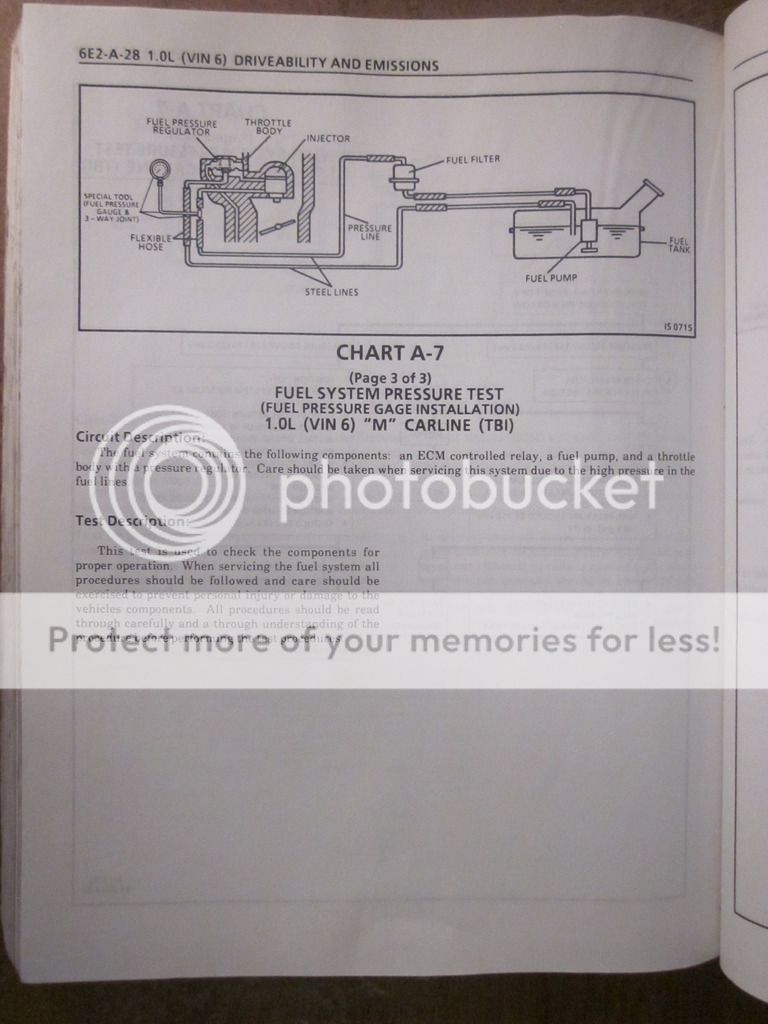

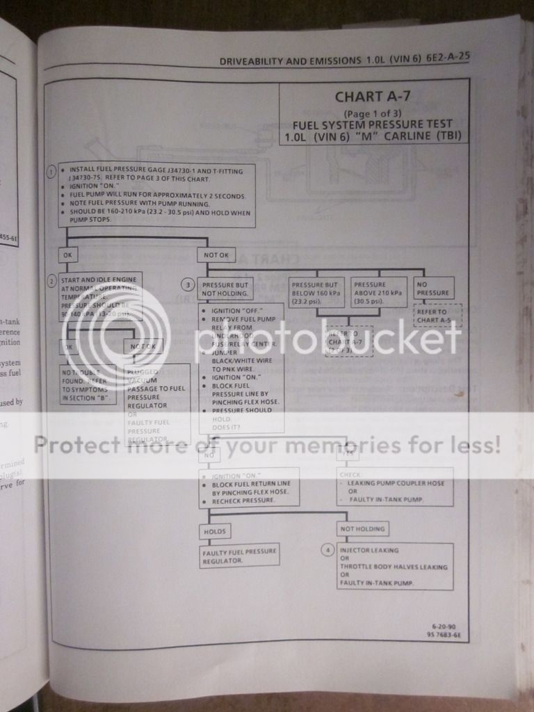

There is a procedure to check the fuel system if the fuel pressure is not right.
Just follow the procedure. Sounds like you have already done some of it. If you have any questions about it don't hesitate to ask.
Jamez
Thank you so much for this great information!
I'm gonna check the return line for blockage and
Retest . I'm gonna try the dead head method by
Clamping off the return line as well and see if pressure
Changes , I was only getting 12 psi running and 12 psi
Key on engine off . I see no leaks and the fuel filter is
New and not blocked . Thank you again for the info helps
Me further the diagnosis .
