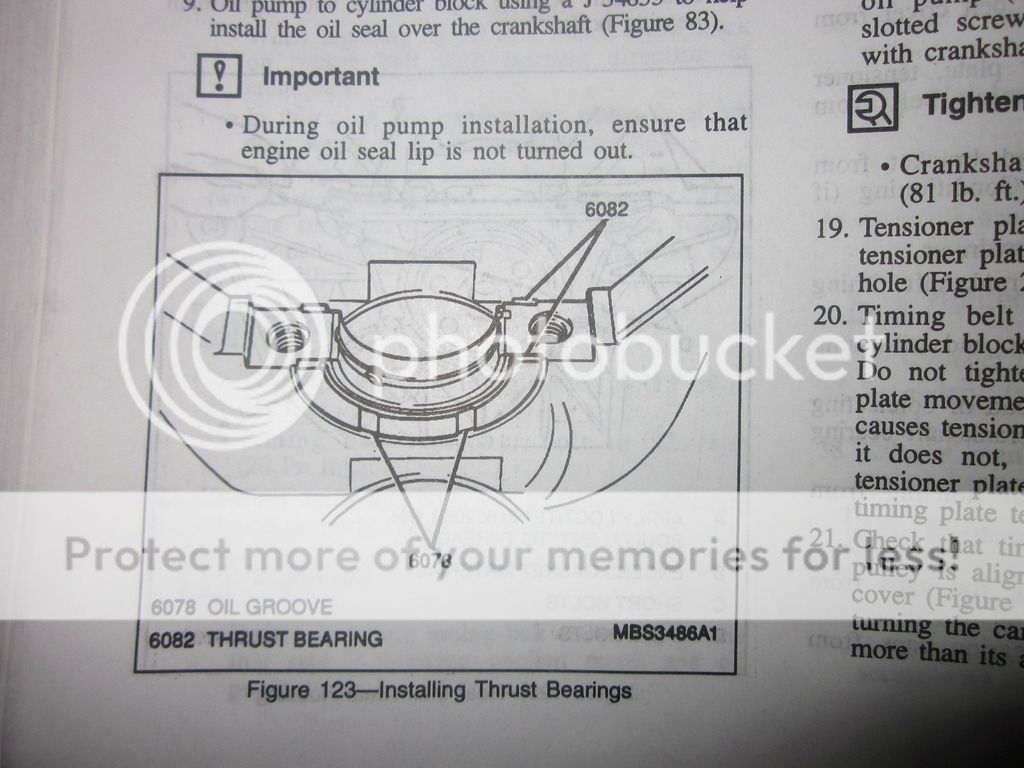

Ironman752 posted a link to a good picture of a thrust washer or bearing as the FSM calls it. There are 2 thrust bearings , 1 each side of the main bearing between the # 2 and 3 pistons. The thickness of the thrust bearings is what sets the crankshaft end play. Below is a picture of how the thrust bearings are installed.
| ptcapboy | Dec 9 2016, 07:08 AM Post #14 |
thanks guys, I was just semi- familiar with rod bearings and main bearings-rod bearings were the only thing I have replaced in my car-appreciate it- |
