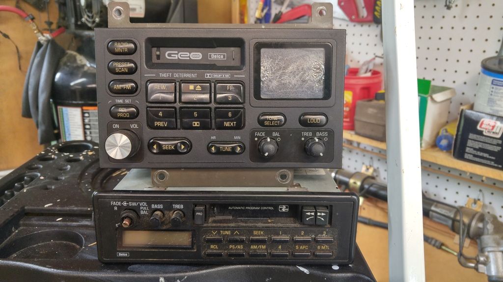

geogonfa
The only two I have left...both do work...the double din needs the clear plastic window replaced...but digital display works fine... :type
Now I'm thinking I might leave the head unit out and use that area for gauges. How much for the single DIN geogonfa?

Just have to cover shipping for the radio...
