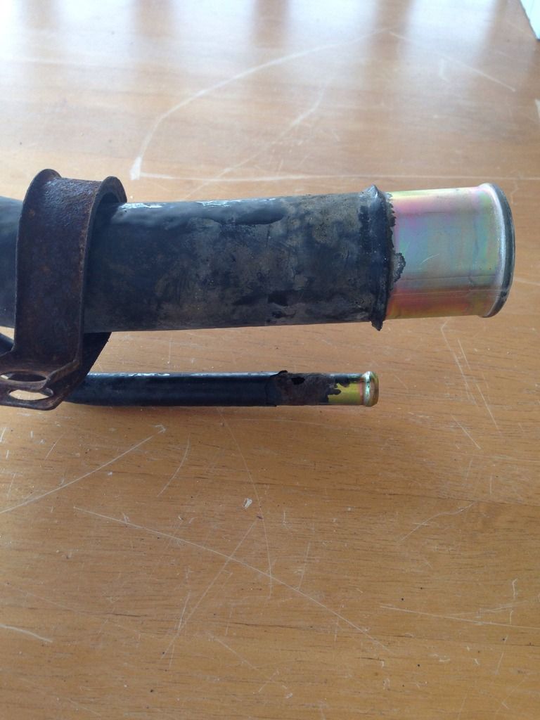

Hey everyone, so I'm having some issues when filling my 93 Swift GT up and wanted to see if you guys have any ideas. When I go to pump gas it will cut it off as if the tank is full, to put gas in I have to barely squeeze the handle. Also while filling the car "burps" gas out of the filler neck. After doing some searching here on the forum I found that it might be my breather tube is clogged or rusted filler neck. Took the filler neck off, blew air through the breather tube and it seemed fine not resistance and no rust on the filler neck. Only one little tiny rust hole on the breather tube, which actually gets covered up by the rubber hose that attaches to it. I wouldn't think that the tiny hole would cause the problems but I'm not sure. Here is a pic of the hole on the breather tube

I have a 90 GT. The small pipe is just a vent back to a fitting on the tank. Did the problem just start happening? Have you tried another gas station? Some pumps have more sensitive shutoff mechanisms and nozzle designs. The angle of the pump nozzle and depth of insertion into the car's filler neck makes a difference also. |

I've only had the car for maybe a month and tried multiple gas stations all with the same thing happening, also tried putting the gas nozzle in at different depths and angles to no avail. When driving the car home from buying it gas actually leaked out from where the rubber tube connects to the filler neck although I put a new clamp on there and it stopped leaking. Still "burps" gas out and cuts off extremely fast
