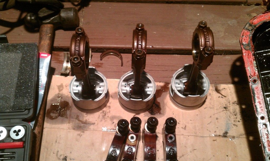

I rebuilt my engine a few weeks ago using This Kit. Add these Valves. My engine runs perfect. I used this Valve Spring Compressor and it worked fine for changing out the valves. To remove the engine I removed the head with the intake attached, then unbolted the engine and lifted the engine out by hand. While the engine is out, you'll want to go ahead and change the clutch assembly (assuming you have the 5-speed tranny). I used this Clutch Kit in mine, but only time will tell how well it lasts. So far, so good.
Other tools you'll need are a 1/2" drive torque wrench, a good selection of metric sockets (1/4" drive, 3/8" drive, and 1/2" drive), a cylinder hone, a sucker stick with valve grinding compound (yes, even new valves need lapped in to make a perfect seal), silicone sealant (preferably the gray, but the red will work too), engine assembly lube (I used moly lithium grease), and other typical mechanic tools (wrenches, screwdrivers, etc.). I used a Haynes manual for reference, just what I had on hand at the time.

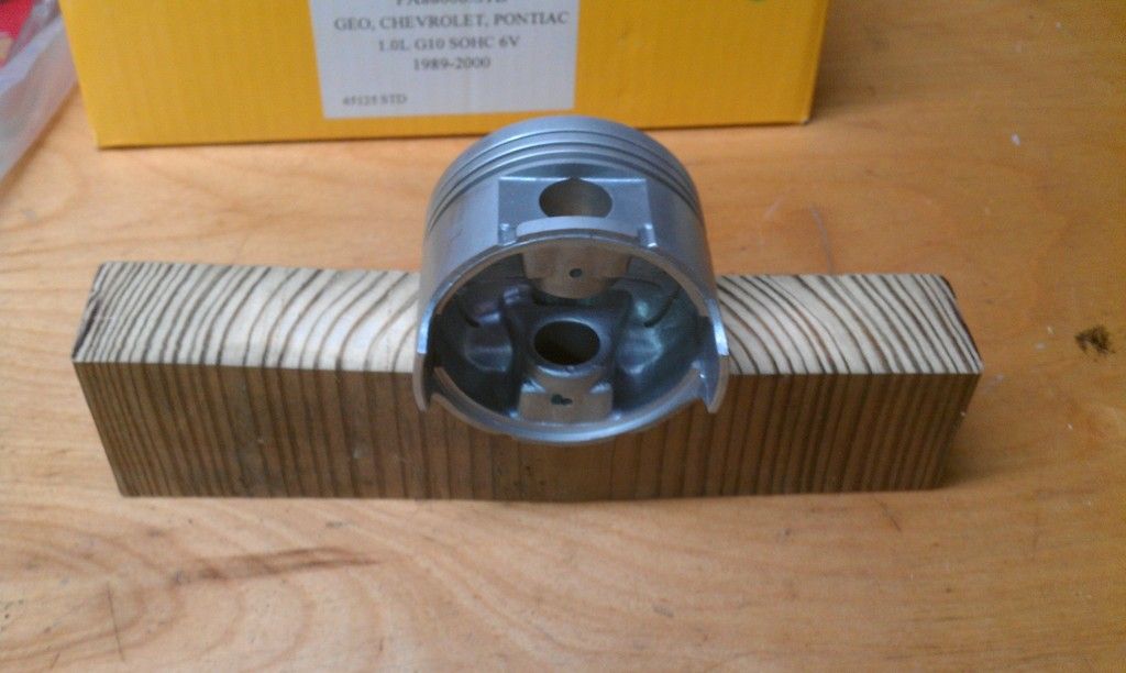

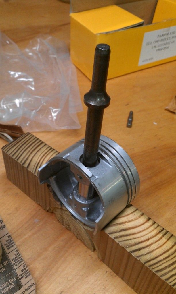

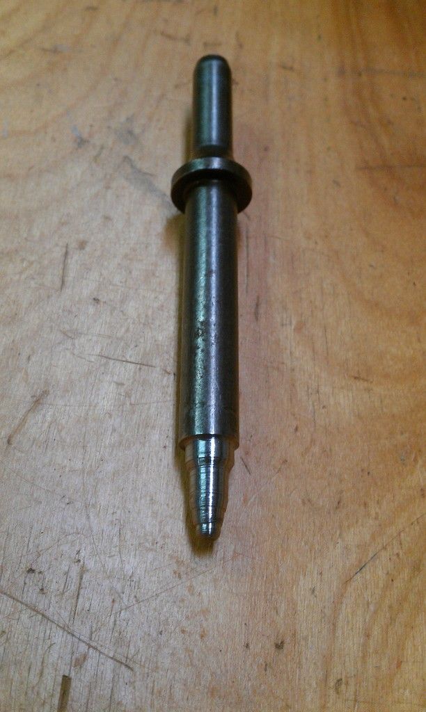

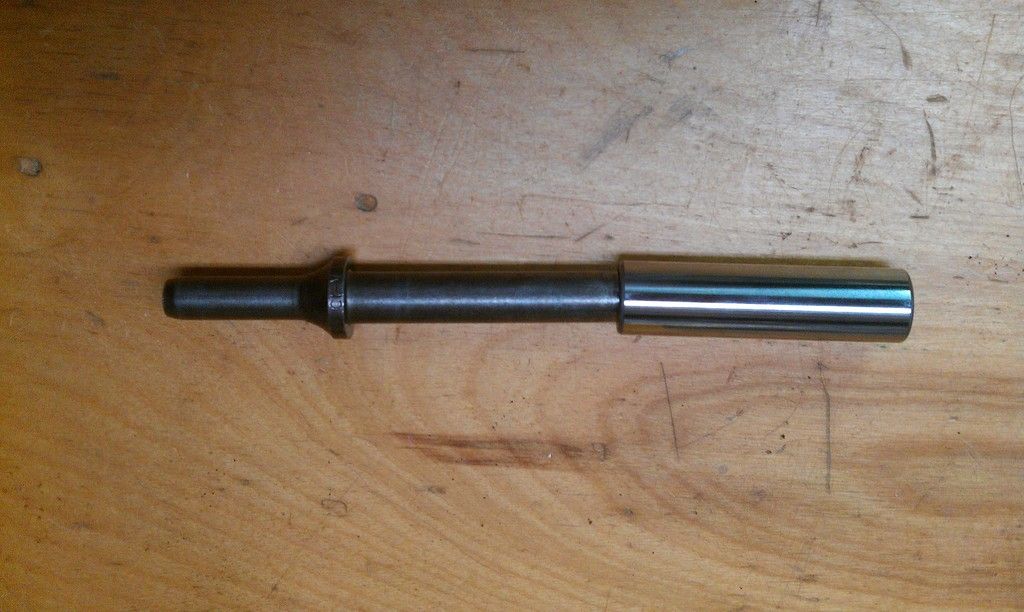

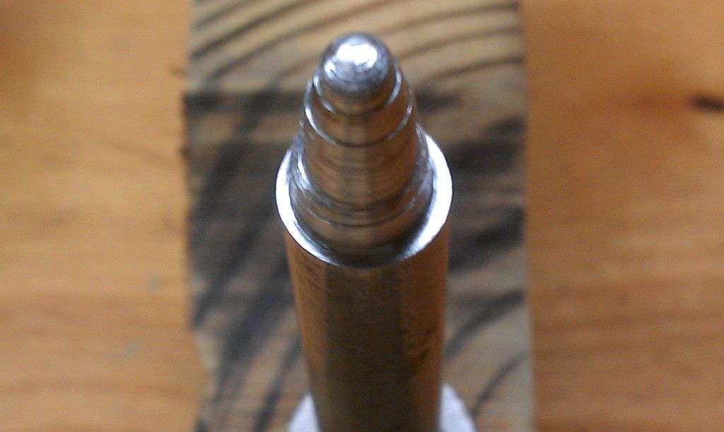

If you plan on changing out your own pistons on your rods, it's tricky as hell, but if you have an air compressor and an air hammer, you can replace them with this setup I used on mine:
I took a piece of wood, traced the edge of half of the piston on the edge of the board, then cut it out on a bandsaw. I then drilled a 3/4" hole through the bottom of it to make room for the piston pin to eject. The punch was one that came with my air hammer. I chucked it in a drill press and turned a square shoulder on it with a file so it'll have good contact with the piston pin. Long story short, it was a total b%$#h to drive out the old wrist pins and line everything up with the rod to drive in the new pins. But it worked. Make sure when driving in the new pins that you oil them first, and make sure that you end up with the same amount of wrist pin protruding from the bosses on both sides of the piston. This may not be a recommended procedure, but it's all I had to work with since I had no hydraulic press. The new pistons looked like this when I was finished:
