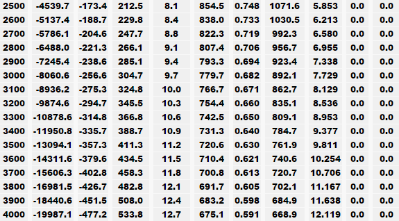

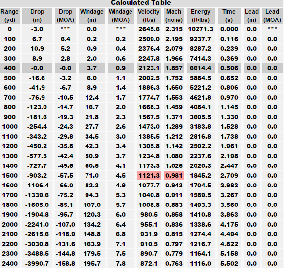

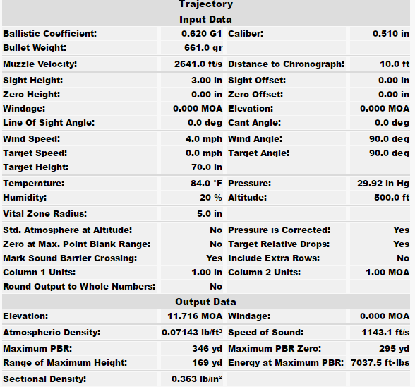

I got my measurements from JBM. Here's what it calculated based on my inputs:
The ballistic table:
According to the chart, the bullet drop at 3900 yards is 18440.6 inches. Bullet time of flight is 11.638 seconds. Bullet velocity has dropped to 683.2 fps. The bullet goes sub-sonic after 1500 yards.
18440.6 inches divided by 12 = 1536.7 feet. That's the total bullet drop that I calculated.

I stand corrected. My bad. :x My apologies to Wizard, too.
I'm trying to envision the hold-over required to get 1536.7 ft of elevation. :O
Either he was, quite literally, shooting for the moon, or his target was, more than likely, located down in a canyon somewhere.
