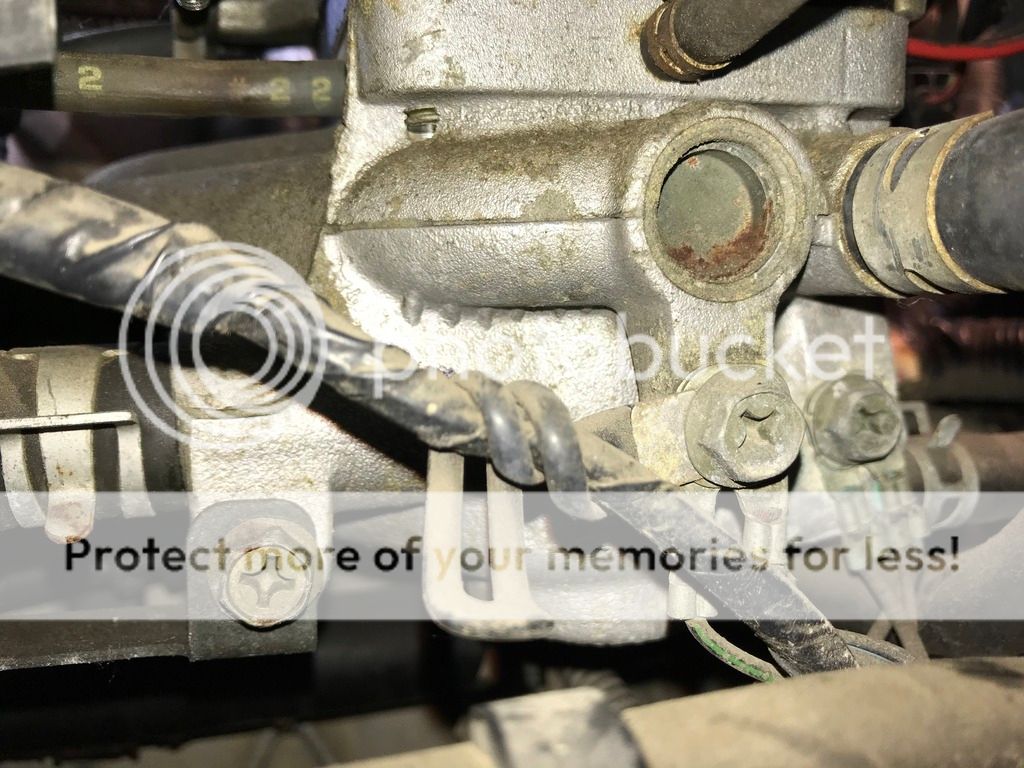

Well...today I get a good high idle at cold and it goes down to 900-1000 when hot. So...idk...seems okay now.
What I do notice different is when you rev, the rams don't fall right back to idle, it takes like 4-5 seconds to finally get back to idle...Is that normal?
And should the pcv valve be a see through tube essentially??
thx
thx
It sounds like you car is functioning normal.
I don't think you should be able to look staright through the pcv valve. Sounds like you should just replace it.
Yes, it is normal for it to take a few seconds to fall back down to idle.
PCV should have a check ball in there, rattle when you shake it, able to blow though it one direction, and not in the other direction.

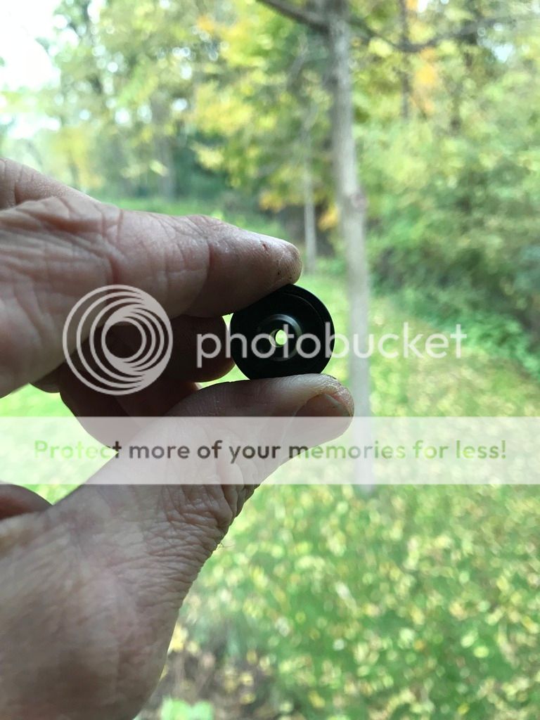

tteerryy
Thank you woodie, . There is something wrong with my pcv, you can blow through both directions and there is nothing in the passageway...So, maybe thats part of the problem? But again, seems okay right now. Saved two bucks from Rock auto...YAY

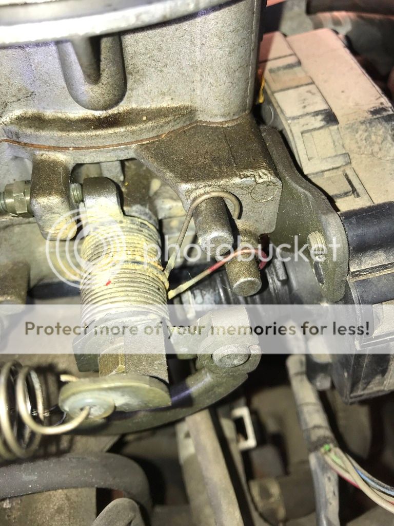

well...I drove it kinda hard for a few days and then out to Austin at 120Kph, and I noticed today that its back to where it used to be when its idling and did go up to fairly high idle at startup..So...maybe it needed to get blown out?? PCV valve will be in tomorrow and see what that does too...I only moved that idle set screw enough to see light in the gap. ..so barely..and if it gets any lower..idling...then I'll put it back where I found it.

tteerryy
Well hell yeah, the old PCV is blow through, no check ball, no diaphragm, no point in it being in there at all in that condition..

Idle seems just right now with a functioning pvc and putting the idle set screw back where I found it.. I'll be interested to see how it acts in the cold.
